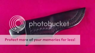

I am in the process of dyeing a sheath black (my first black dye attempt) and it's not going well. I put about 4 coats on last night because I kept seeing the brown natural leather color vaguely through the black. This morning I watched a video posted by Springfield leather and they stated I should have wiped off the black film before proceeding to the next coat. Well I went ahead a put on my last coat and went to bed. This morning I grabbed my kiwi black leather polish and was just going to use that as my final finish /conditioner since it is all they I have. As I rubber in the kiwi a lot of the black came off and yet once again I can see the natural leather color.
Okay, so obviously I botched my first attempt, my question is what steps should I now take to finish this? Can I go back and reapply more dye now that I have rubbed off the excess black? Should I clean with denatured alcohol and then dye?

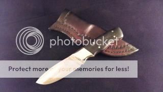

Well I put another coat of USMC on and let it dry. It looked real good until I start polishing it and a lot of it came off. I was upset at first, but then realized it looked kinda nice, so here it is.
Hey bud, not bad! Part of all of this is adjusting your expectations and it looks like you've done just that. Next time I suggest trying the method I outlined in the other thread, but for now you've got a cool looking piece of work. If I'm honest, some of my very favorite dye jobs came by pure accident. In some cases I couldn't reproduce the effect if I tried.
Good job!
