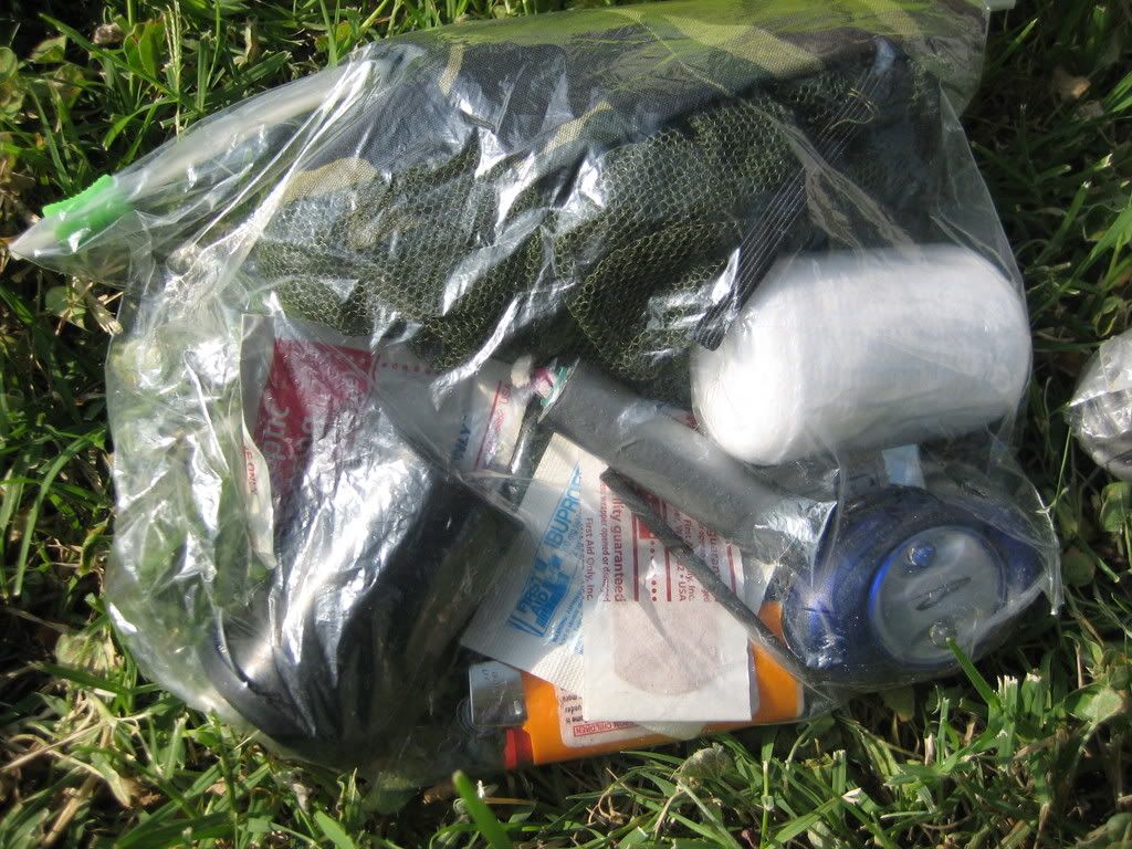

Ditty bag with firestarter-first aid tent stakes and guy lines-6 oz.

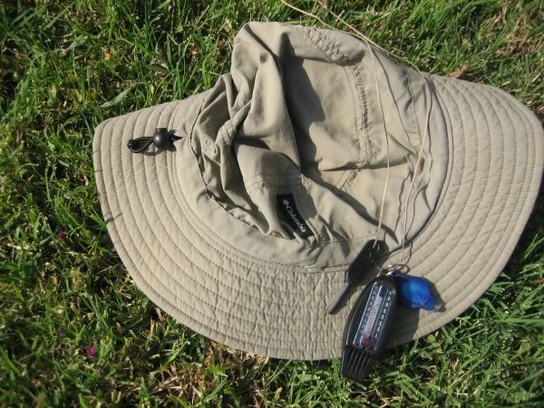

As far as hats go, I like the Columbia broad brimmed hat with the mesh all around. Tilley's are always touted, but I have too many other toys to buy without spending that much on a hat. If you like baseball caps, you can add a cape to it (they're sold by Campmor, REI, etc.) or you can make your own by just tucking a bandanna in the back of your cap.
