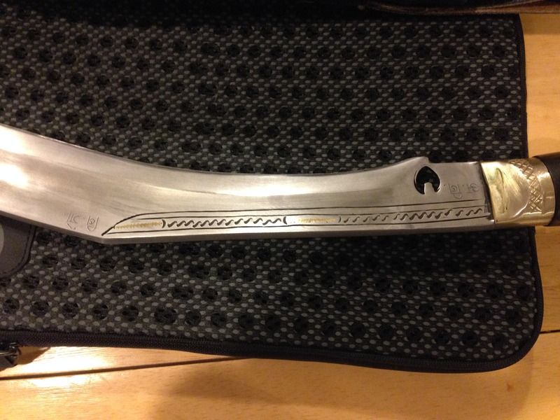

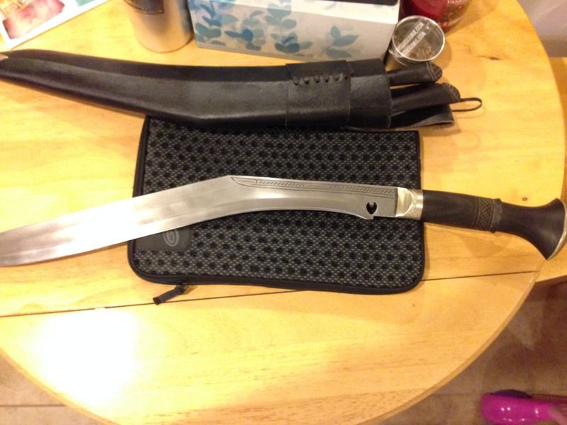

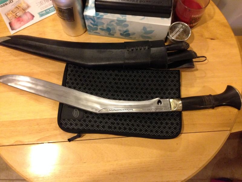

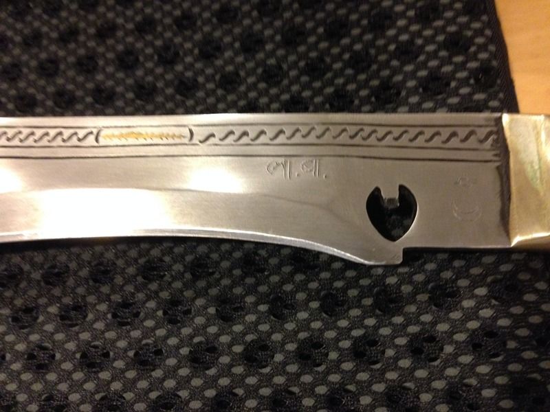

I have had this big Kukri for years, but I honestly can't remember what model it is or which Kami made it. Can one of you wise HI nuts chime in? I know it's something special as I don't remember seeing many inlayed kukris out there. All help is appreciated!!

I think it's horn. I was originally looking into Ren wax. Does anyone endorse it for kukri use? How can I tell if it's horn versus wood? I am only asking as I feel like it's horn but the lighter portions resemble wood grain, normal?? My best guess would be rough finished buffalo horn.
That's strange, the right side I'd swear is horn but the left side I'd swear is wood. Guess I just swear a lot.
I think it's wood.
Ballistol or mineral oil works great on horn and not bad for wood either although I prefer multiple coats finger rubbed of linseed for wood.
26". I just looked at it again, I found some hairline cracks. It's gotta be horn. Ballistic I will order.
