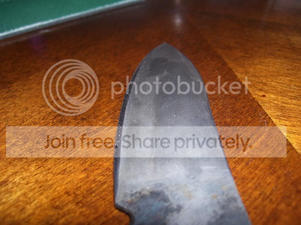

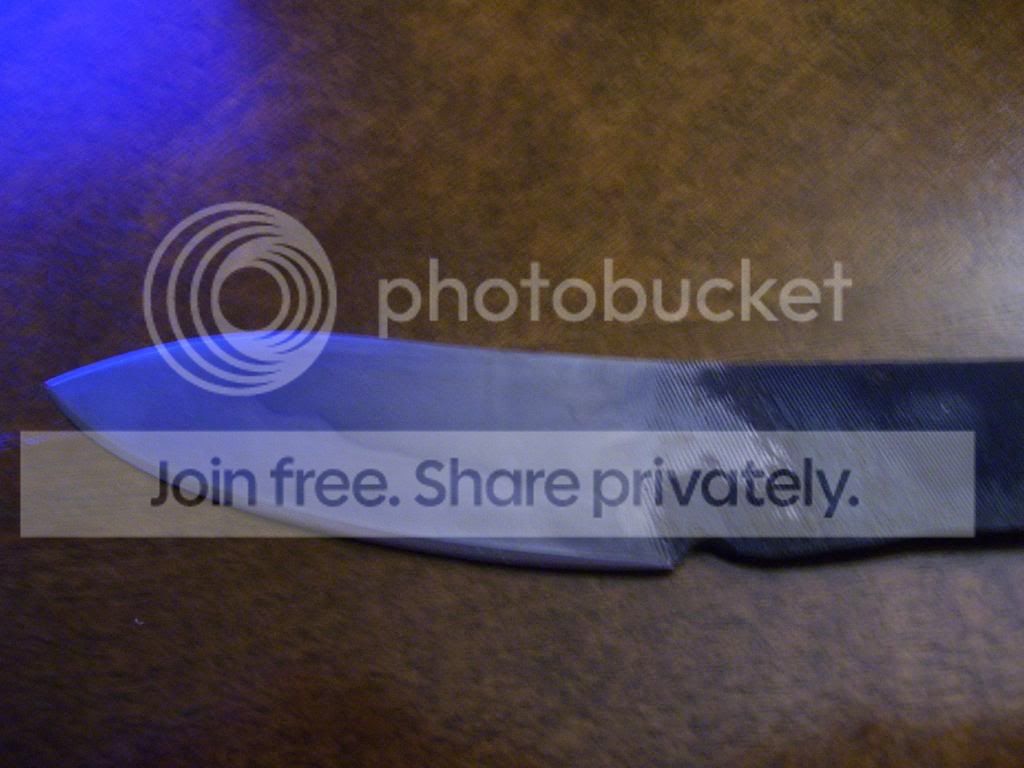

Just as a proof of concept, I took one of my old, but quality American made (figured it was close to 1095/W1 or W2) files, put my heat treat furnace on "afterburn" and lo and behold I got a good forging heat. The only thing I had to forge on was a piece of I-beam and the concrete floor of my shop and a brand new 4lb huge faced Kobalt hammer. Forged something that looked vaguely like a blade and did a furnace anneal. Next day, finished it up on the grinder. Took some of the tailings from drilling out some firebrick and made a paste. Applied it to blade and straight into the furnace. Cherry red and nonmagnetic in about 30 seconds, then into the water quench. One second in, one out, two in, one out, then left it in. So, at this point I was thinking "If it comes out in one piece I'll be happy, much less if it shows a line". Well wouldn't ya know... after a little cleanup and a hot vinegar/dish soap etch here's what I had:

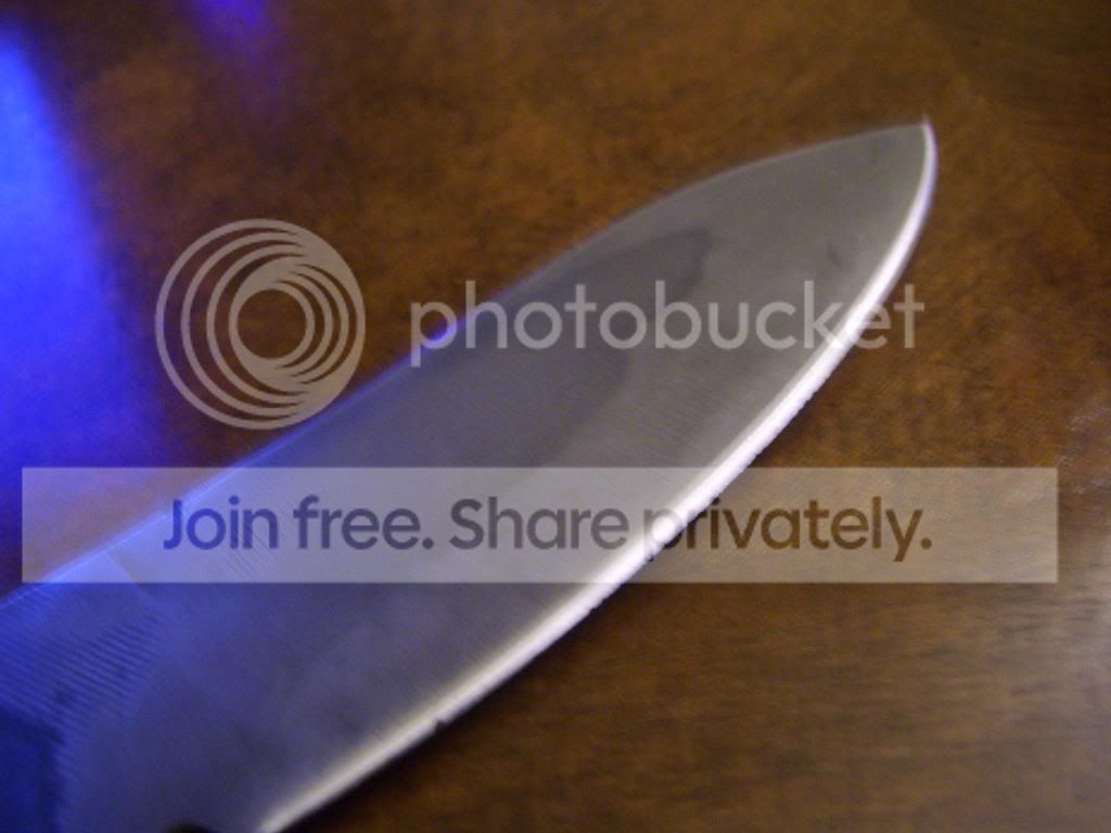

I didn't even temper it, but I put an edge on it and used it to skin a deer on Wednesday. You can see the chips in the edge. I think I'll temper it, re-etch it, and finish it out. First forged knife, first temper line, and first knife from surplus steel all in one.
She's sharp, too.
