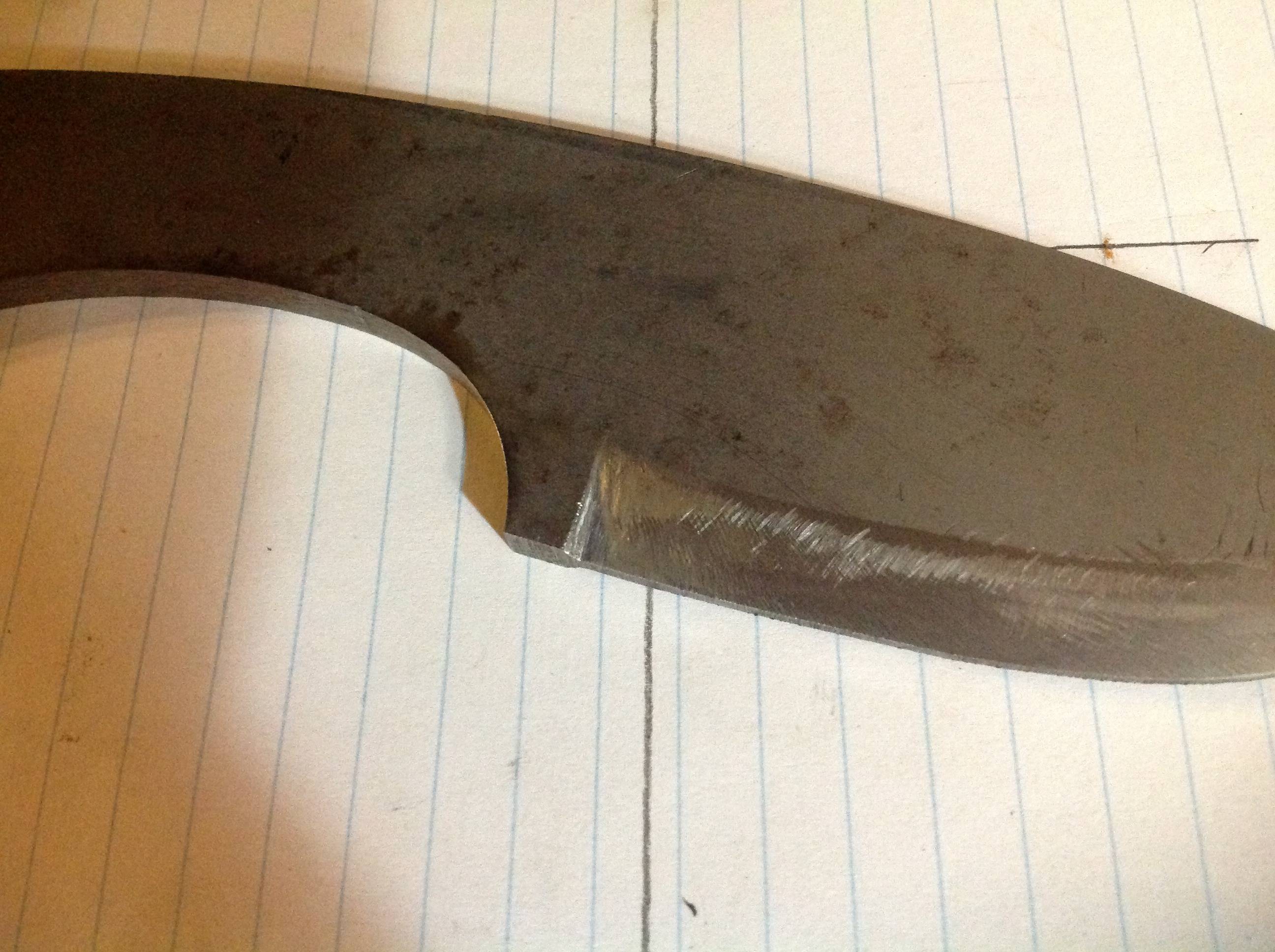

I have sarted many blades in the last year and not completed one... Its getting VERY discouraging.
The issue is with the shaping of the blade. I make a profiled blank easily enough but when I try to shape the blade edge I keep running into the same issues and I then put the blade away and start another just to run into the same thing again.
ATM im trying to make simple drop point hunting knives with a flat ground edge.
I cant get a clean plunge line with a belt grinder. So I flat grind the blade with hand files.

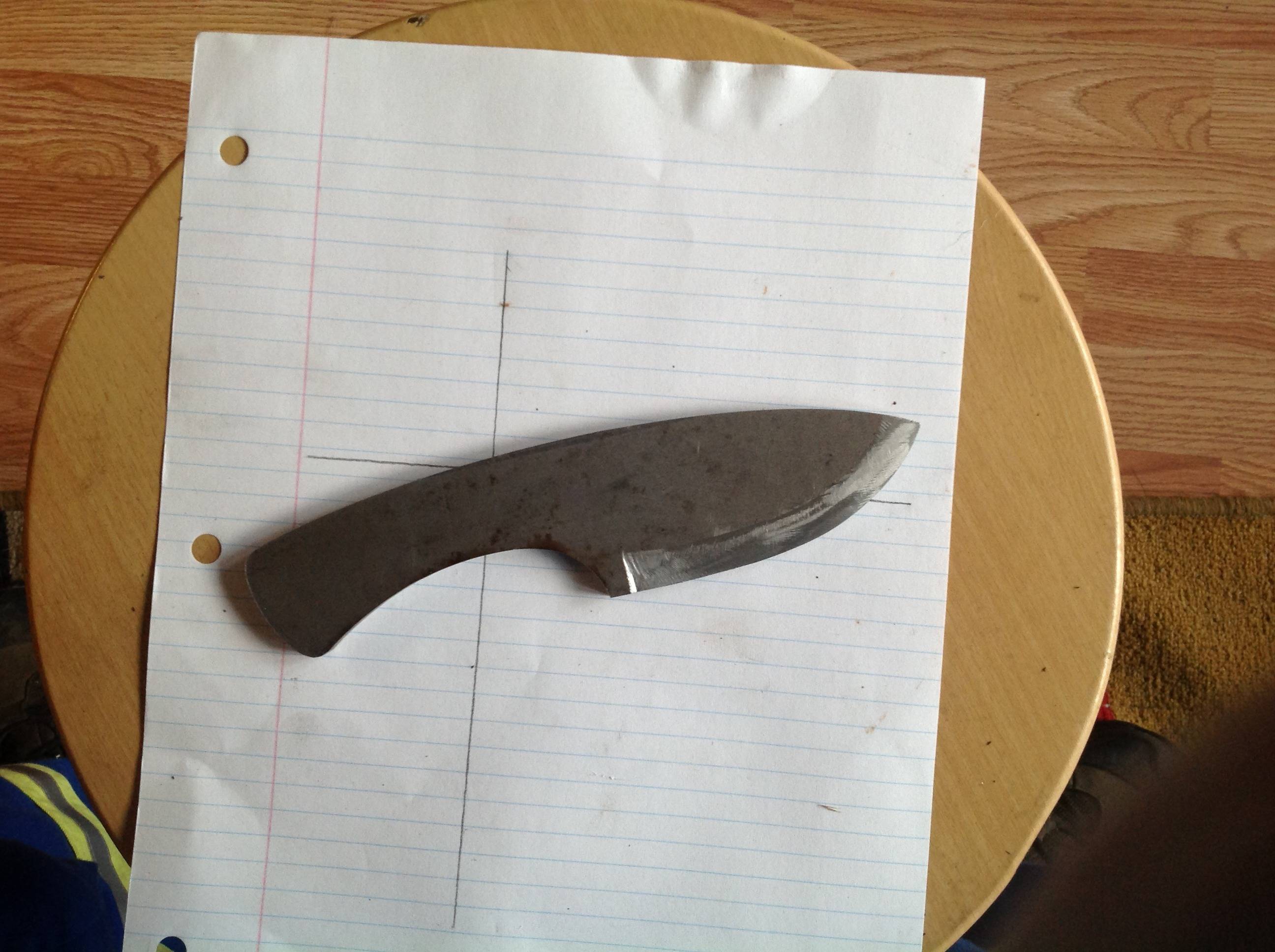

Even with the files I cant get a proper plunge line. Its difficult to describe but I keep cutting into the ricasso and getting a tapered plunge line instead of a nice clean cut if that makes sense. Im actually having a difficult time with my filing and edge shaping in general and cant find a lot on how to get a nice clean shape. I made this simple 1084 drop point today just to practice. I hope these pictures of it load I would appreciate some opinions on this... Its a standard example of my technique (or lack of) Thanks!

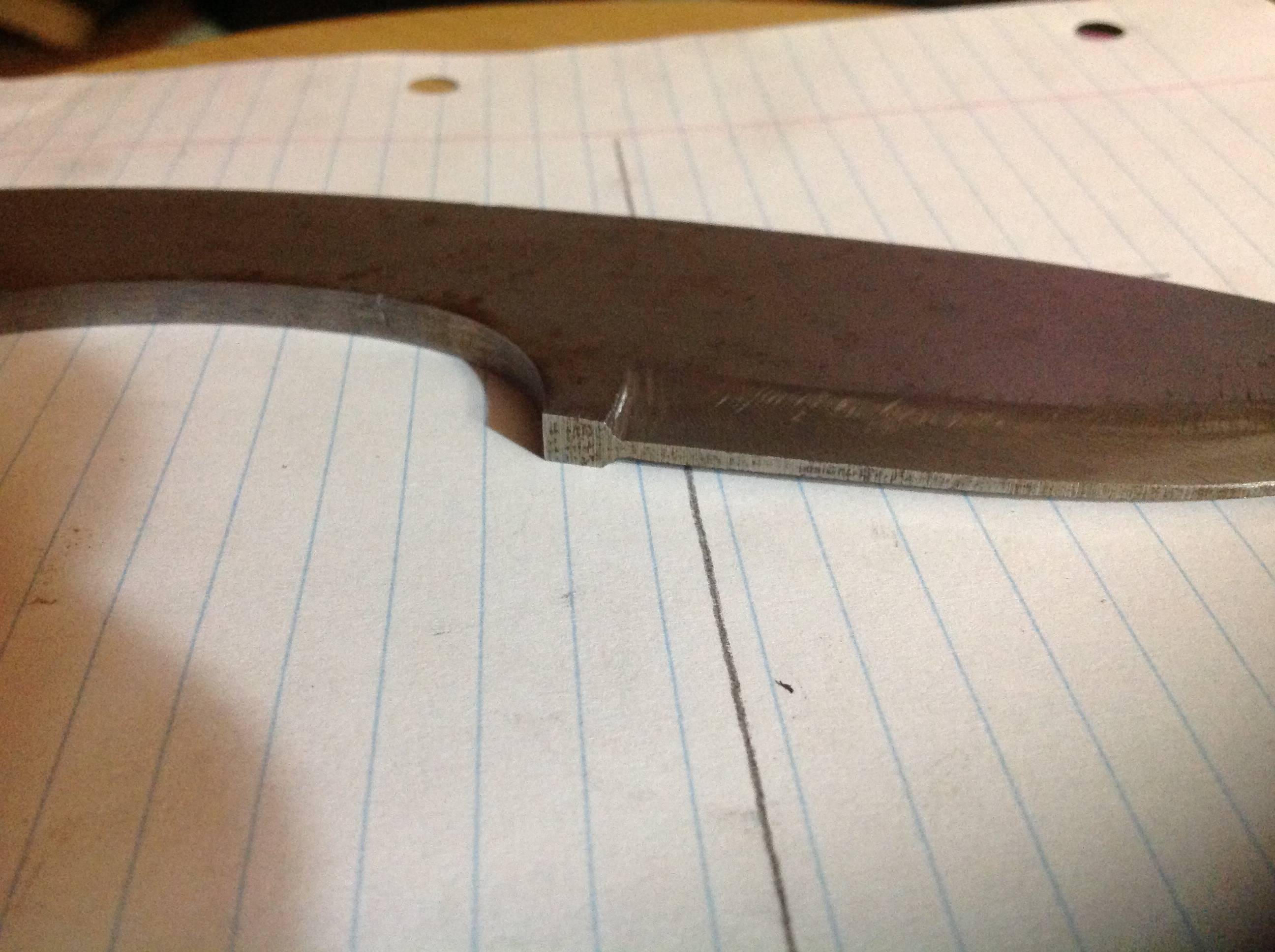

You can see in the second image the square surface at the bottom of the ricasso... Im not sure what this part is called. There you can see where it tapers to meet the blade edge rather than a nice square shape that I'm trying to achieve.
Not sure if I am understanding correctly but a plunge should typically be a bit rounded and not a sharp squared cut. A perfect square plunge from ricasso to edge may seem appealing but it can also produce a possible weak point or stress riser in my opinion. Others with more expertise may have another opinion.
you could get what you want by using a smaller finer square file, but most makers seem to do a more rounded transition as Grayzer notes - which you could get using a small fine round file.
I agree with the other guys about stress risers and think it looks pretty good so far and you're well on your way. Try draw filing and keep moving the bevel up. Post more pictures when then edge is about as thick as a dime.
I think your plunge lines look fine, they should be rounded some what. Don't let something like that stop you from completing a knife, I have found even with flaws, a completed makes you feel good and you can learn from your mistakes. I like the shape of that knife by the way!:thumbup:
That looks good to me. I would carry it higher up the side, though. Personally, I like full flat grinds, where the plunge goes all the way to the spine.
One way to get things lined up and make filing easier is to purchase a file guide. It is a pair of hardened bars of steel ( some with carbide faces) that are held parallel with two bolts connecting them. This is placed where you want any straight and equal line from side to side. They are also great for getting the shoulders on hidden tang blades dead straight.
http://www.knifemaking.com/product-p/fg100.htm
As to the sharp cut plunges, as said, it may look neat to be a perfect 90°, but that isn't as great metallurgically. The transition should be a curve in the perfect plunge. Many makers start the cut with a chain saw file against the file guides, and then switch to the flat files to file the bevels in.

Wow thanks for these replies they answered my questions and then some! It had crossed my mind that squared up might not be good... Now I know! That makes it much easier. A while back I was thinking it would be so much easier if I could make some sort of hardened steel file guide. I didn't know there was such a thing already. That will also come in handy! I like the idea of grinding some files smooth on one side too. I have been rolling the idea around in my mind of bringing the edge up higher on this blade or all the way to the spine even as well. I went with this simple flat grind because I still cant for the life of me figure out how to get a decent hollow. I could hollow on a straight edge but cant make it curve to follow a typical edge profile. Thanks for the help !
