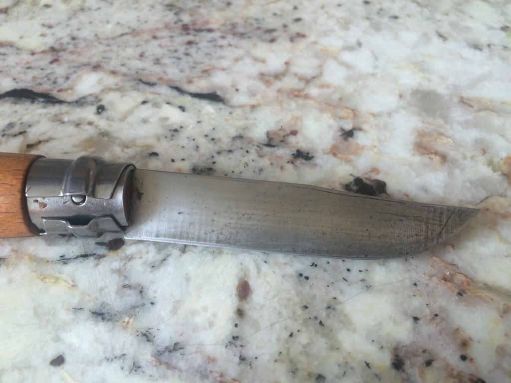

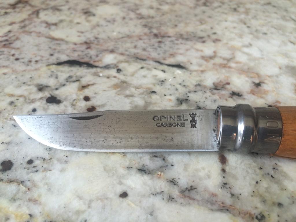

It's no.8 opinel that we've been using in the kitchen daily use. The blade looks in a really bad shape with corrosion but it cuts really sharp still. The wife says we need to get rid of it but I want to save it and bring back to life! Any tips appreciated. I want to post picture but the forum has disabled photos for tapatalk.

ok here are the photos
[/url][/IMG]
[/url][/IMG]
hope it's not beyond recovery :o:o:o
It's not beyond recovery. ;)
Assuming the blade is pitted (looks like it is), the pitting could be sanded out, or mostly so, with a block with wet/dry sandpaper wrapped around it, and the blade supported against a firm backing. OR, just lay 1/3 or 1/2 a sheet of wet/dry over a hard, flat surface (glass, stone, hardwood) and move the blade against that. I used a similar method to thin & polish blades on two of my Opinels. The 'carbone' blades will sand easily, and some 220-400 grit wet/dry paper should work pretty fast. Might start with the 400; if that turns out to be a little slow, move back to 320/220 and try again. You don't necessarily need to remove all the pitting, if you don't want to. Take the wet/dry as far as you like in grit; anything up to about ~600-800 will leave a finer satin finish, and 1000+ will start to bring up a mirror shine.
If the pitting doesn't bother you that much, you could just scrub the blade with WD-40 or mineral oil, and steel wool or a wire brush, to get rid of any red rust. The dark grey/black patina won't harm the steel at all, so you needn't worry about that. After scrubbing the red rust away, clean the blade and use some metal polish like Flitz/Simichrome to shine it up a bit.

Agree with OwE ^^^
Opinel blades are pretty thin so you're not likely to sand out any deep pits.
Once clean just wipe it down with Mineral Oil to keep it that way.
I would go the steel wool route. It'll clean the blade up and leave the character.
I agree with jpm2, some steel wool will get it back up and running as good as new, ( might not look new, but it will have some character ) then apply some light oil, or use the simichrome to polish it up. Then slice up some apples or oranges and let it sit overnight to get a nice layer of grey patina on it. Then just make sure it is dried off good after using or cleaning and it should not rust any further. I have cleaned up several carbon knives this way with good success.
