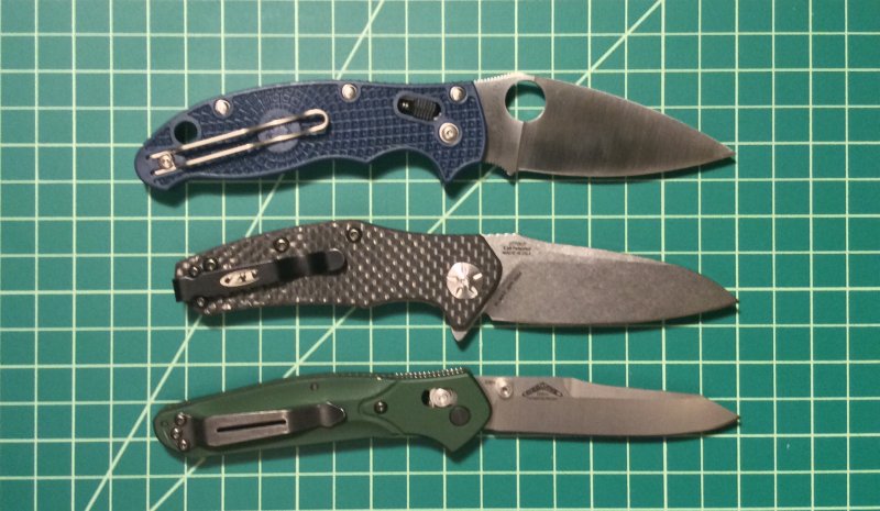

Both the 0770 and 940 are great EDC knives. I have a 0770CF (CF handles and Elmax blade) and the regular 940 (aluminum handles and S30V blade).
If you are looking for a slicer, the 0770 may fit your needs better. Both the 0770 and 940 use the same thickness blade stock, but the primary bevel on the 940 is about half the height of the 0770. As such, it will be at a higher angle than the 0770, which will make it act more like a wedge, depending on what you are cutting. That said, the 940 with its CF handles and S90V blade still seems like a pretty sweet knife.
You really can't go wrong with either.

flarp,
Thank you for the input and the picture! I am now leaning toward 0770.
Since you have the Manix 2 LW S110V as well, could you give me your impression on ZT's Elmax against it?
I own Stretch 2 ZDP-189 and thought that there wouldn't be a noticeable difference in edge retention between ZDP and S110V in my light use, but S110V really outperforms ZDP-189. And I like Manix 2 a lot because of that. I know that Elmax may not be that good, but I would be happy if it is close.
