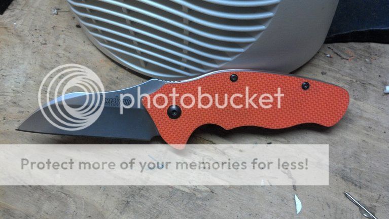

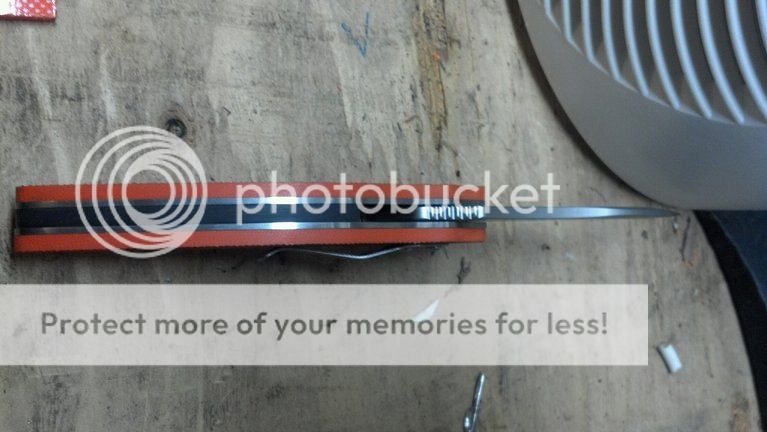

Here are a couple of pics of this thing. It's getting close to being finished. I still need to round off the corners on the scales and try to figure out a way to get my dirty finger prints off of the textured surface of the scale.
This has been a pretty interesting project. I under estimated it quite a bit from the beginning . I pretty much figured that it was just going to be drill a few holes, sand the edges smooth and call it a day. It was quite a bit more than that.
I learned a lot on this one, and my next set should come out better and faster, but I'm still a long way from where I want to end up.
Thanks again for the help and for following along. I'll post pics once it's all finished.

Well, its all boxed up and ready to go to my brother tomorrow. I'm pretty nervous about giving it to him, but I'm pretty sure he'll like it even if he doesn't understand what exactly happened to it.
I said that I would post some pics when it was done, but they're the same as the last ones. Lol
Thanks again for following along.
thanks for the kind words. My brother got it today and he seemed pretty excited about it , but I'm not sure he really understood that I had done anything to it. Lol. Oh well, as long as he uses it and doesn't lose it or brake it , I'm happy. Lol
