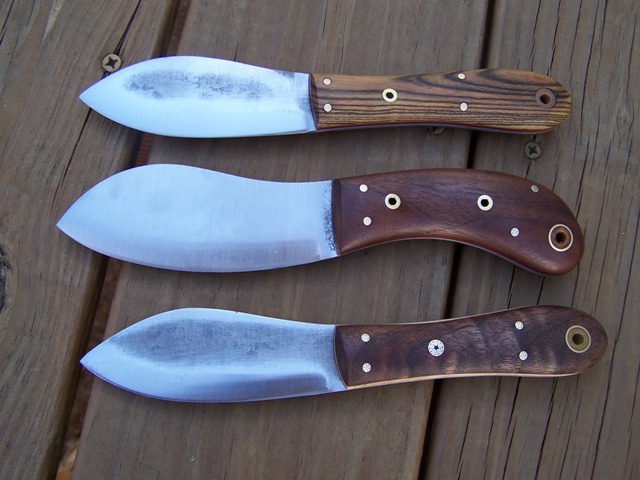

Newer knives in manufacture but the concept is still the same.
I don't think they're the most ideal blade for any function. They do great in the kitchen (if you get a nice thin bladed model). They're good skinners (I think thats what the hump is for).
I like em because they're the anti-tactical knife.
Scott Gossman, Dan Koster, Muskrat Man, Ilbruche all make fantastic ones.:thumbup:
