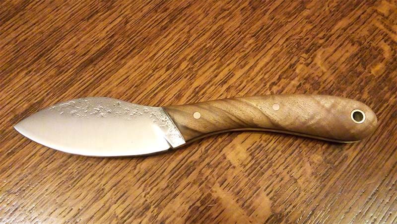

Just finished these two.
My take on making Nessmuk style knives. They were forged from ball bearings, and it was fun to make them.
Wenge wood with black G10 for handle material, and horizontal right/left hand carry sheath
Overall length 9,25"
Blade length 4,7"
Thickness 0,157"
Walnut burl with black G10 for handle material, and horizontal right/left hand carry sheath
Overall length 8"
Blade length 3,5"
Thickness 0,118"

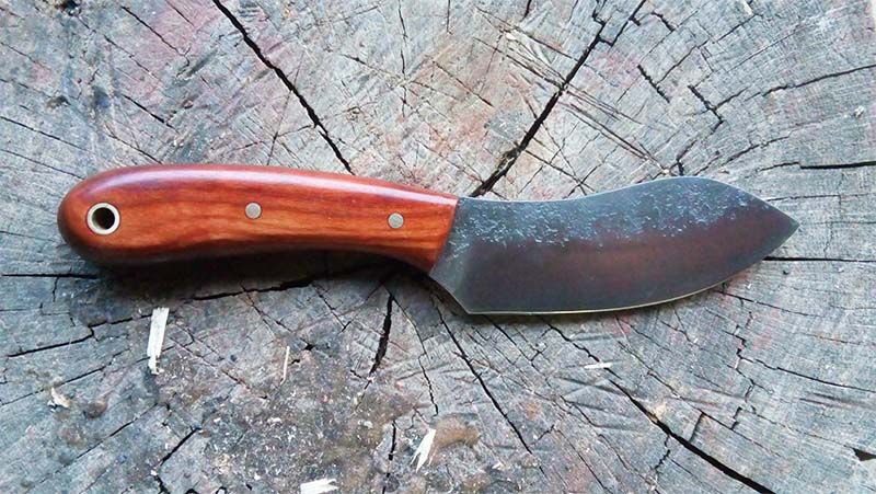

Here is another one:
Plum wood with black G10 for handle material, and vertical right carry sheath
Overall length 8"
Blade length 4"
Thickness 9/64"
