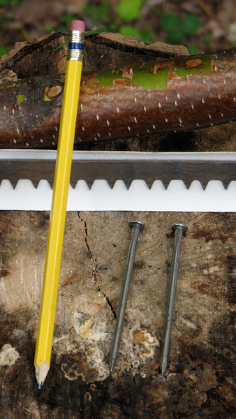

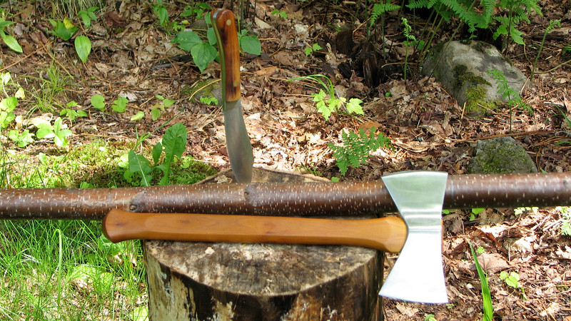

Here they are. These very items may have formed the basis for Nessmuk's Bug Out Bag, INCH Bag, or as he probably called it his Pack. People back then were a lot less dramatic. Instead of making up fancy names. They just did stuff.

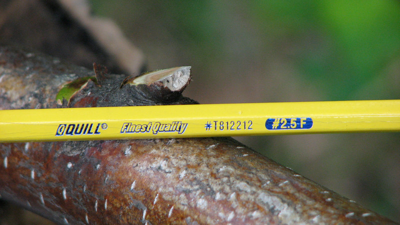

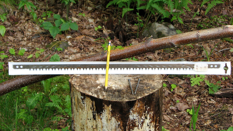

You need to understand, these are not just nails and a pencil. This is a Quill "Finest Quality" 2.5F (The F stands for Forest). The nails are coded #10 Bright Common, to throw civilians off the track. High tech stuff.
This is one of the most sophisticated communication devices known to mankind.
It surely originated from Black Ops. It works in any language. You can use to leave messages that will last for years. It needs no batteries. Doesn't depend on the grid to function. It is also a calculator and an emergency fire starter. That's just the tip of the iceberg.
While we certainly have better steels available to us today. I would venture to guess. They had better hand saws and saw blades available to them. Because they did everything by hand.
Old axes and saws still command high prices because they just plain work better than the new stuff. For this jaunt I will use a modern saw blade. Because it was what I had hanging in the shed.

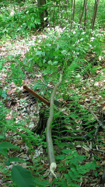

For all the stuff in the store, I was surprised there weren't more people. It had a nice open airy feel to it too. I purchased a small sapling from the multi-use department.
They let you cut it yourself like those Christmas tree farms.

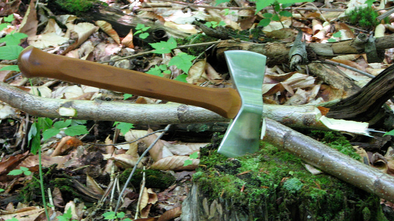

My hatchet made quick work of it. Although in a pinch I could have easily batoned Mr. Sears' knife through it. Here it is at the checkout.
I pruned off what I didn't want. And left it to dry for future kindling.

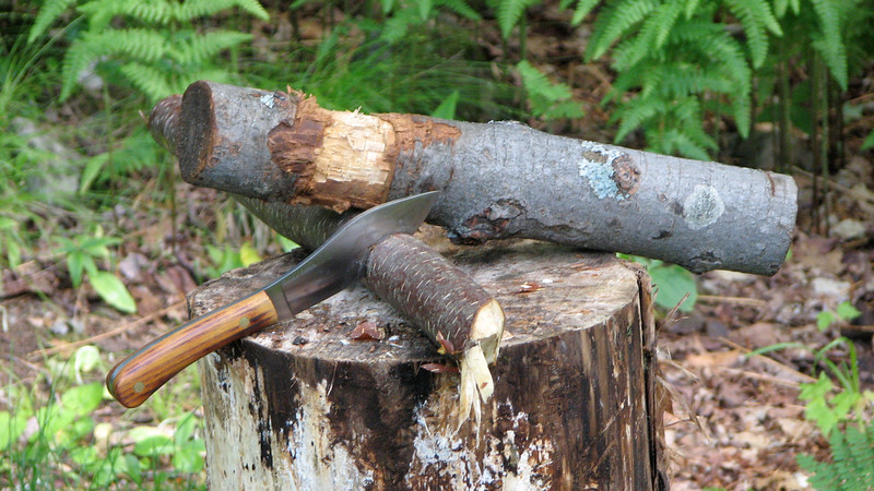

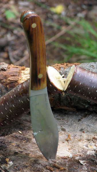

I took my sapling, which is now more of a stick. And set out to construct a saw. It is amazing how well a sharp knife will cross baton through green wood.

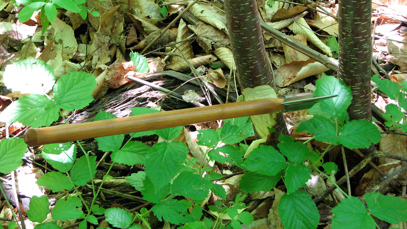

I used my hatchet as a measuring tool, it is roughly fifteen inches long. And used my Quill #2.5 to make some marks. Some day I should break down and actually scribe the handle with 1/4 inch measuring increments. Giving me a one foot ruler again with zero weigh or space penalty. But for now, it is too pretty. If I was living in the woods. It would already have them.

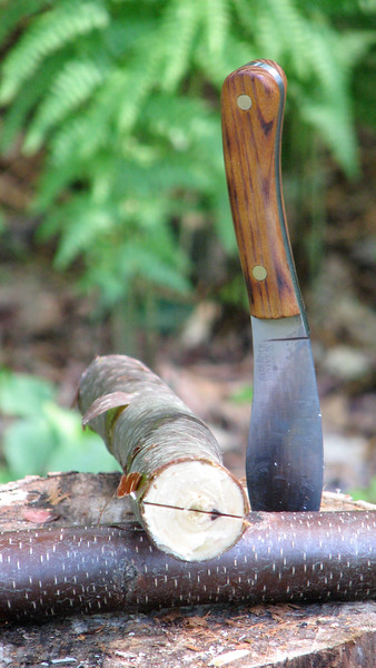

Just three quick cross baton cuts gives me my two uprights and one end of my cross brace.
Here is a shot of some of the center wood that finally pulls apart when you work your way around the the stick with the baton.

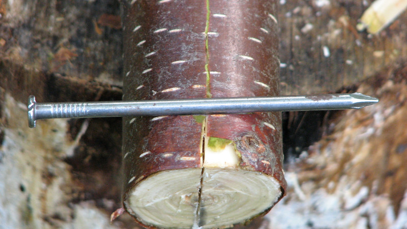

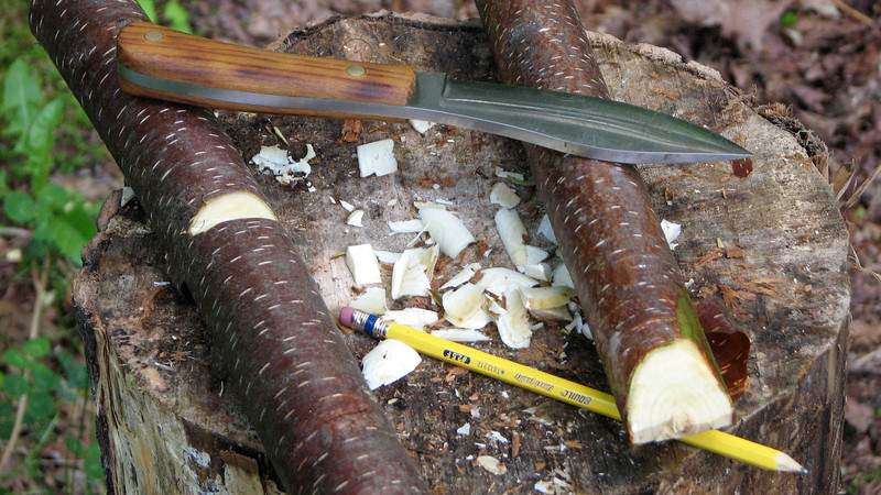

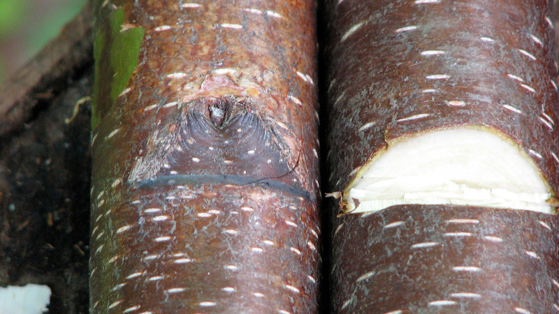

Next up we baton our knife into the bottom ends of our uprights. I recommend doing this before cutting all your other notches. Because if it splits out, all the other work is wasted. Do this gently, and just go in far enough so the saw blade will fit with the upright angled in slightly.
Once you get the two ends split for the saw blade. Make some measurements for the notches. You need six notches, three per side. Two at the bottom to hold the blade. Two for the cross brace, and two for the tensioner. Once you do the first side, just cheat and copy over to the second side.
These high tech survival tools are so cool. I just wish they weren't so expensive.
They really are as tough as nails,
And this pencil thingy, what an amazing tool. I bet some day in the distant future when the price comes down, everyone will own and use one. Ever try and mark a stick with a cell phone?

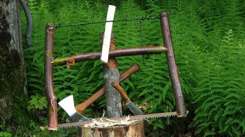

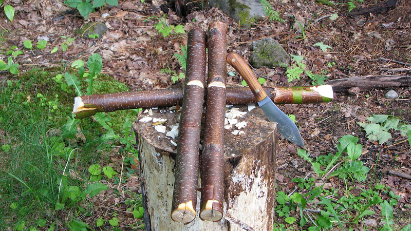

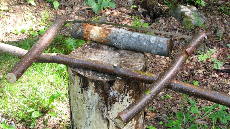

It begins to look like something, I stuck the blade in to get a rough idea of the cross bar length.
Everything cut but the final cross bar bevel,
With all the cuts made, notches in, and all the pieces ready. All that is left to do, is put it together.
Here is the one place where we may have an advantage over old Nessmuk and his friends. Para-cord, this stuff rocks. It is cheap, it lasts, and it works. Some of my old saws have metal turnbuckles for tensioning. They work great, but they are heavy and single purpose.
I imagine wet rawhide would work extremely well here too. I didn't have any or I might have tried it. Today it was Para-cord
It took me longer to set up the photography, than to build the saw. I tied this to Nessmuk. But I think everyone should have one or two of these in their packs, whatever they may call them. Add a saw to a knife/hatchet combo, and life suddenly makes sense.

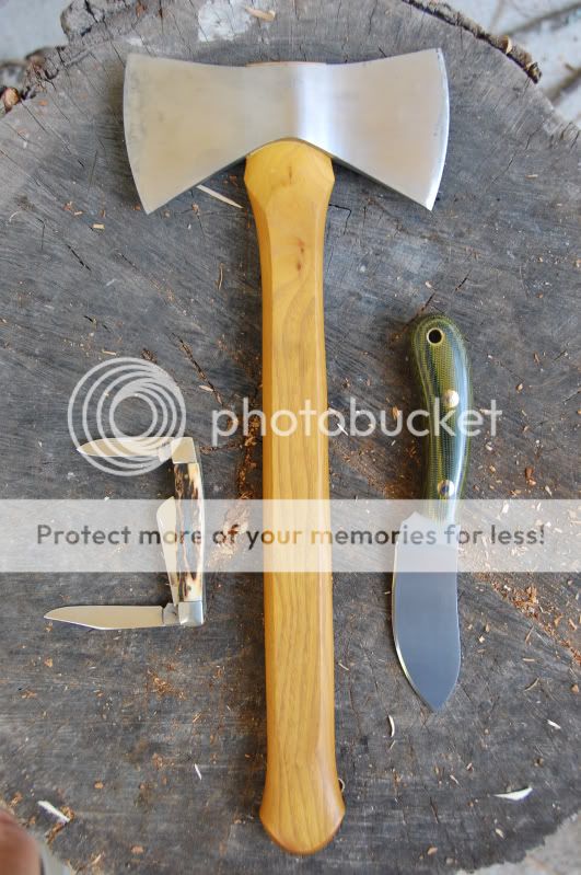

Great story. I appreciate the time you have taken to post this. I have attached my Nessmuk trio. I need to get out there and use 'em.
