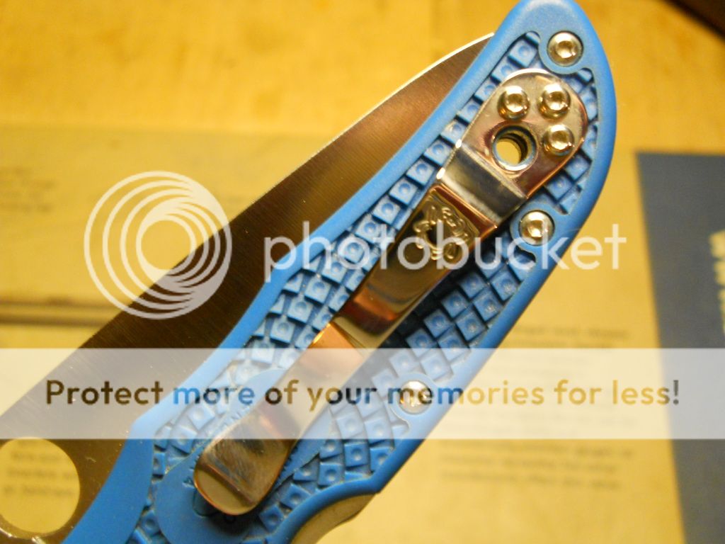

Never did this before....I'm impressed!
First I put the clip into some KLEAN STRIP paint stripper, its a paste. Let it sit for around 15 minutes. Rubbing it with a q-tip. After cleaned it off and got some polishing compound from my dremmel...went to work and then got a clean buffing pad and then buffed it again all with the dremmel. Then just wipped it clean with a cloth. My wife and son said it look better then the clip on my manix 2 XL. Gonna do it with her purple delica.
Looks good, I think it looks better than the factory coating on some Spydercos. I polished the clip on my Endura 4 and I'm happy with the results. I took the coating of with a razor blade and went to work on the clip with a Dremel and some Flitz. Really didn't take that long.
Still has some polish on it in the pic.
Nice...the pic I took doesn't do it ant justice.
Together with this polished clip the knife has much more harmony and it looks much better now.
Great job :thumbup:
Excellent work!

Yes, exactly what I think about the Delicas and their clips. Polished looks much cleaner.
