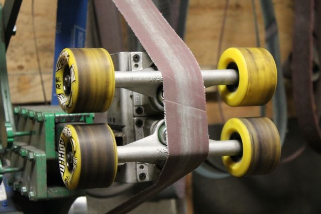

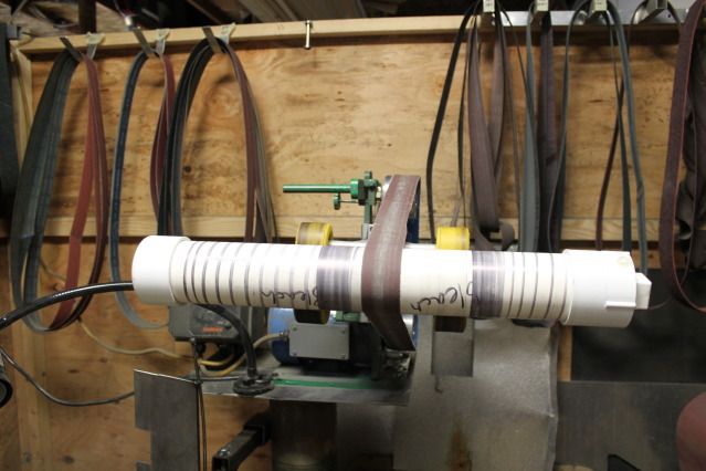

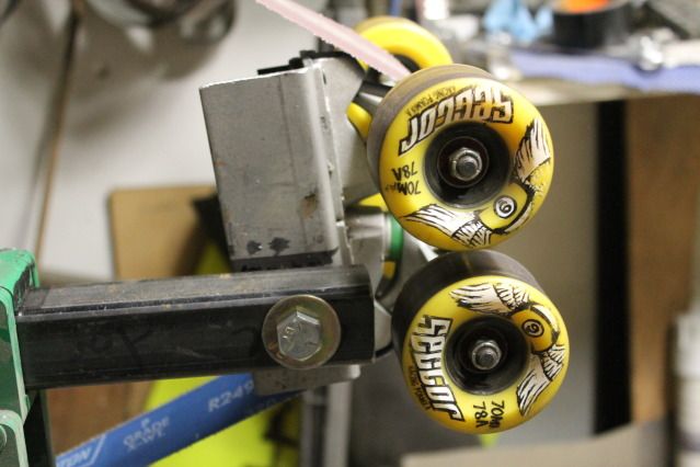

So I like making all my own tools if possible, partly because I enjoy it. But mostly because I am CHEAP! I had this crazy Idea to cannibalize my longboard and make a tumbler attachment for my grinder. So this is what I came up with. It will hold up to a 22" blade. :D

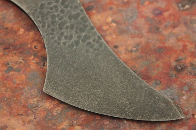

I cold blued than tumbled this blade with ceramic media for about 45min.
I now next to nothing about stonewashed/acidwashed finishes, so any pointers would be helpful.

the small diameter of the drum may be giving you a small scratch pattern.
maybe a larger drum?
Are you using any liquid like a simple green solution ?
Yes, I might try using a bigger cylinder and add some fins or angles to help with the tumbling action. Right now I can only run it on the slowest speed otherwise centrifugal force takes over and everything stops tumbling. A larger cylinder would also slow the gear ratio down which should help as well.
Right now I am just using a little water in it.

Do you have any trouble keeping the tube centered? Does it want to creep toward one end or the other?
Yes it does like to drift Phil, if I find the sweet spot it will stay pretty centered though.

That is a brilliant field expedient solution. A larger drum and some kind of thrust bearing would make it just about perfect. I wouldn't want to tie up my grinder for hours of tumbling but I have all the parts to do this within 10' of my grinder! A slow rotation and larger drum would give better contact between media and parts but I might just try this. -H
I just saw this thread and i agree with everyone, this IS GENIUS! have you tried substituting a leather stroping belt belt instead of the abrasive belt? I figure they would have more grip on the pvc tube.
