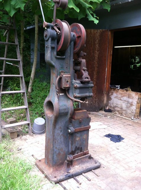

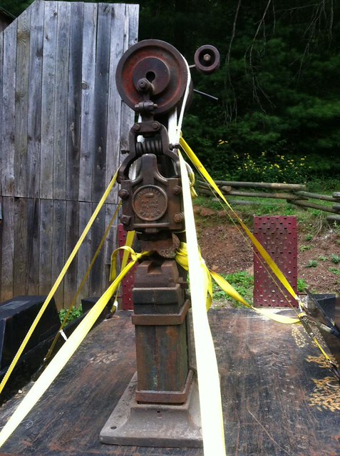

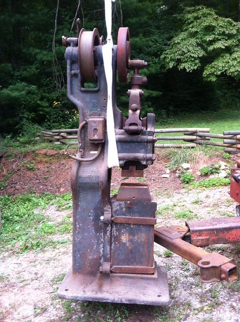

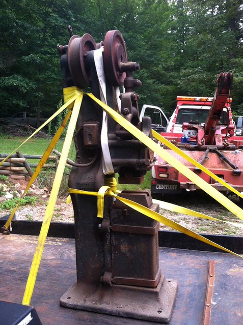

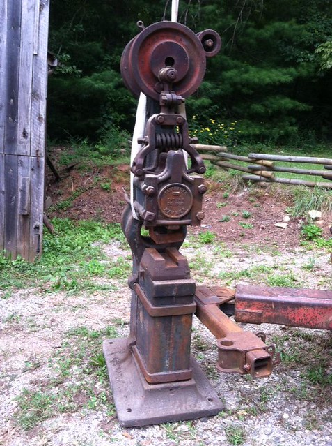

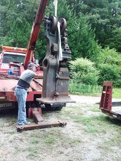

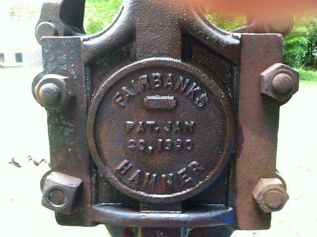

Well as many of you know power hammers are a bit addicting. I enjoy the "hunt" for good ones. Was recently talked out of my Little Giant #50, so I ramped the search up for another shop hammer. Found this 75# (B) Fairbanks that was at a decent price, and close by (3 hours in the world of hammers is "close").

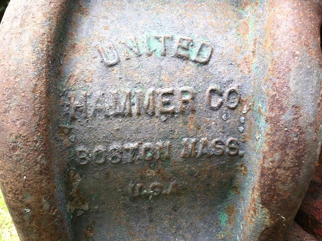

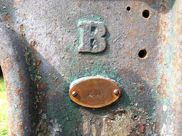

This one was made in the 20's from the limited info. I can gather. Has a United marked frame, and I think they (United) purchased Fairbanks in 1918. Long story short the hammer has been under a tarp since the 80's, and doesn't look like it was used much or hard during its life. Everything is "free" yet fairly tight.
Have a 5hp 1150rpm motor that will power the hammer. Im hoping a 4" fiber pulley will grab enough belt to run efficiently. Also have to fab. a treadle and treadle bar, shouldn't be too hard, although I see no tabs etc. for the treadle to attach.
Spring will need to be addressed too, the one in it is too short. Ive had more then 1 person tell me a 50 LG spring will work.... we will see.
a few quick pics-

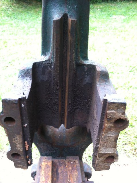

Nick, Yes I have both dies. This hammer was set up for 1 specific use judging by the dies. They are a huge set of flat dies, with the bottom die having a "V" groove across the face. I will likely have a new set of dies made, and modify the current set for more traditional use.
I was able to take it to the car wash and blast off a lot of the old loose paint etc... and my thought that the hammer wasn't used much was further supported by just how clean/tight/unmodified the hammer is.
The biggest issue is going to be figuring out how to attach a treadle, as there is nothing I can see to bolt it to etc. So I will likely make a heavy "hinge" plate that will bold to the lower rear (there are already 3 threaded holes). From that I will have a good attachment point for the treadle/linkage (which will also have to be fabricated).

Thanks for the link Bill. Ive searched and found a few pics of linkage set ups. Seems like a pretty easy task overall, a lot of Fairbanks hammer had single sided treadles, you had to order the "full" wrap around type. Going to try and make some time this week to take the top end apart/clean/inspect/paint etc...... Pics to follow.

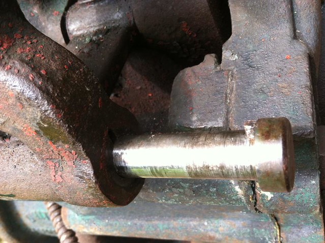

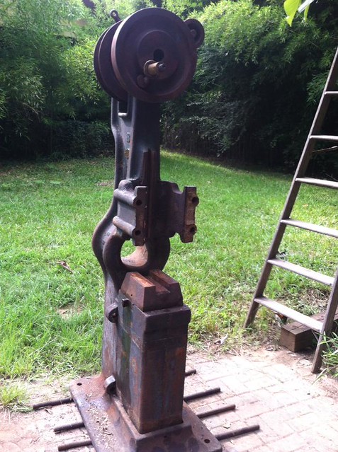

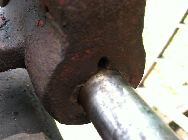

Any how I worked on the Fairbanks some today, and was pleasantly surprised to find that this hammer hasn't seen much work at all. Judging by the lack of forge scale, and the "cold" work marks on the dies, im guessing they were using this hammer for thin stock or even sheet metal.
There was little to no wear on the toggle link and upper arm pins. Crosshead bushing didn't have excessive wear either. There is a little more play in the toggle links on the ram side, but im thinking this may be intentional.
Whats interesting is that although the Fairbanks "B" is a #75 weight hammer the ram without die weighs 94# . I think this was fairly common for hammer manufactures to put a heavier ram in to show folks "how hard it hits for a #75"..... kind of like bowyers marking bows a few lbs. lighter then they actually are, or putting 5.0 badges on a big block etc...
A few pics from today-
Heres how it looked after blasting any loose paint, and taking most of the moving assembly apart-
Very nice. I see that was made in Boston. Just a stones throw from me. I can only imagine that there is more of them tucked away in some old warehouse nearby just sitting.
