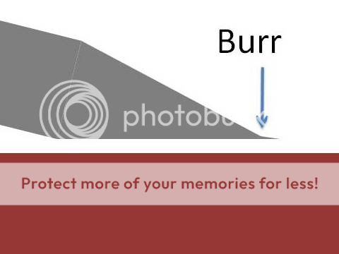

ok thaks. whats a bur. sorry im very new to this. and also when do i know to switch from sharpenning on one side of the knife to the other?

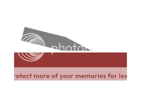

A burr is a thin strip of steel that is built up on the edge of a blade when it is sharpened.
Below is a diagram of the cross-section of a blade and a stone
If we zoom in on the edge we can see the burr
As soon as you can detect a burr the sharpener has done its job. You don't want a burr to get to big though. Some people look for a glint of light on the edge to indicate a burr, others can feel them with a thumbnail, Richard J just told me about using a needle suspended from a thread to find one. The needle will slide across the blade and then get caught right at the edge if there is a burr.
When there is a burr it is time to flip the blade and/or switch to a finer stone
Generally you want to get rid of any remaining burr before you are done sharpening, and there are various options for doing this. Very fine stones, ceramic sticks and strops are some of the most popular.
