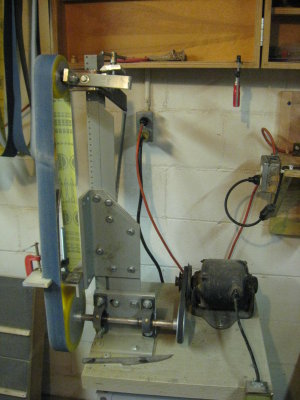

Here's a belt sander I finally got going this week. I started buying parts for this in 2006 after reading "The wonder of Knife Making" by Wayne Goddard.
It runs a 2x72 belt. The drive wheels are from Sun Ray http://www.sunray-inc.com/ It has a 3/4" shaft I bought at "Rural King" and had a buddy of mine put a key way in it. The body is made from an old Chatsworth computer rack we threw away at work. It's powered by an old Maytag motor. It could use something bigger, but this will do for now. I'm still working on the tool rest...What's on there now is just temporary.
I've got almost $200 bucks in the thing so far, but it seems to work pretty good.
Now I've just need to practice grinding bevels and I should be on my way!
