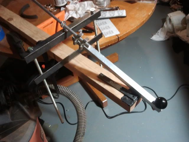

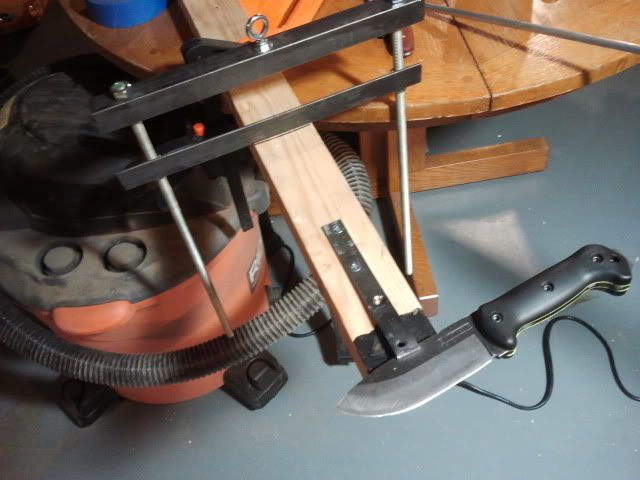

This isn't very portable, but it gave me a wicked convex edge. It's a bit advanced but it works awesome.

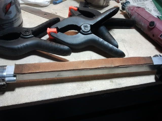

I used an old leather belt for convexing, and use the flat side for a V bevel. I use regular sand paper, and work my way up.
