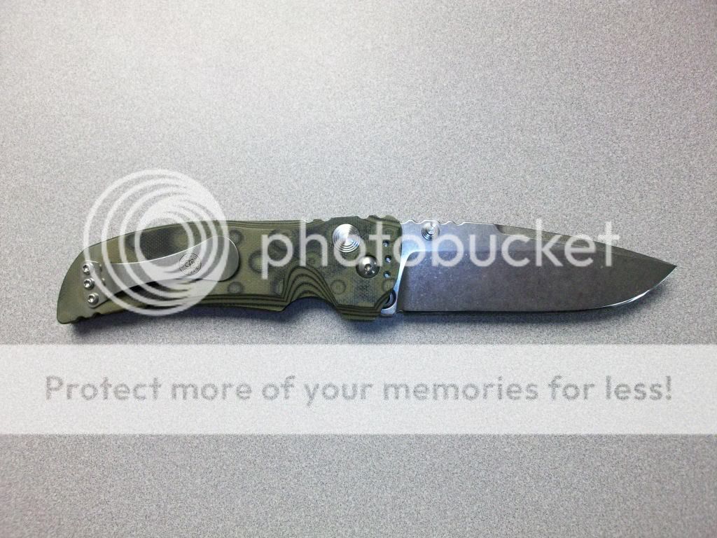

I never pay them much attention, and have never seen a factory edge that I would be "happy" with, well, except my Hogue EX01, that baby came perfect, right out the gate. Even toting the polishing I put on mine.
I did nothing to the edge when this pic was taken....
