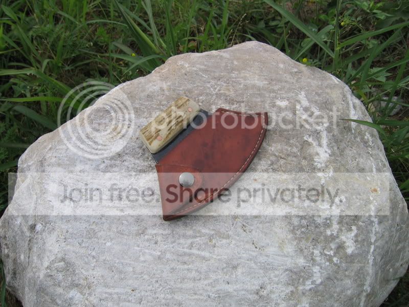

I had fun making this one... forged from a piece of O1 that was 1/2" x 1 3/4" x 2 1/2"..... no flat plate here folks!
Rick
Finished specs...
The Hunter's Ulu
O1 steel
1/16" thickness
5 3/4" cutting edge, Convex ground
3 7/8" from back of handle to cutting edge
3" long stag handle with copper pins
7oz Leather sheath, snap closure, hot dipped in a beeswax mixture.
looks like a nice one.
i like that sheath too, nice and sturdy and simple. is there a belt loop or is this a bag knife?
I want to know too. Ever since I saw that big one you did in that burlap micarta, I have been droolin. I want one BAD!!!
