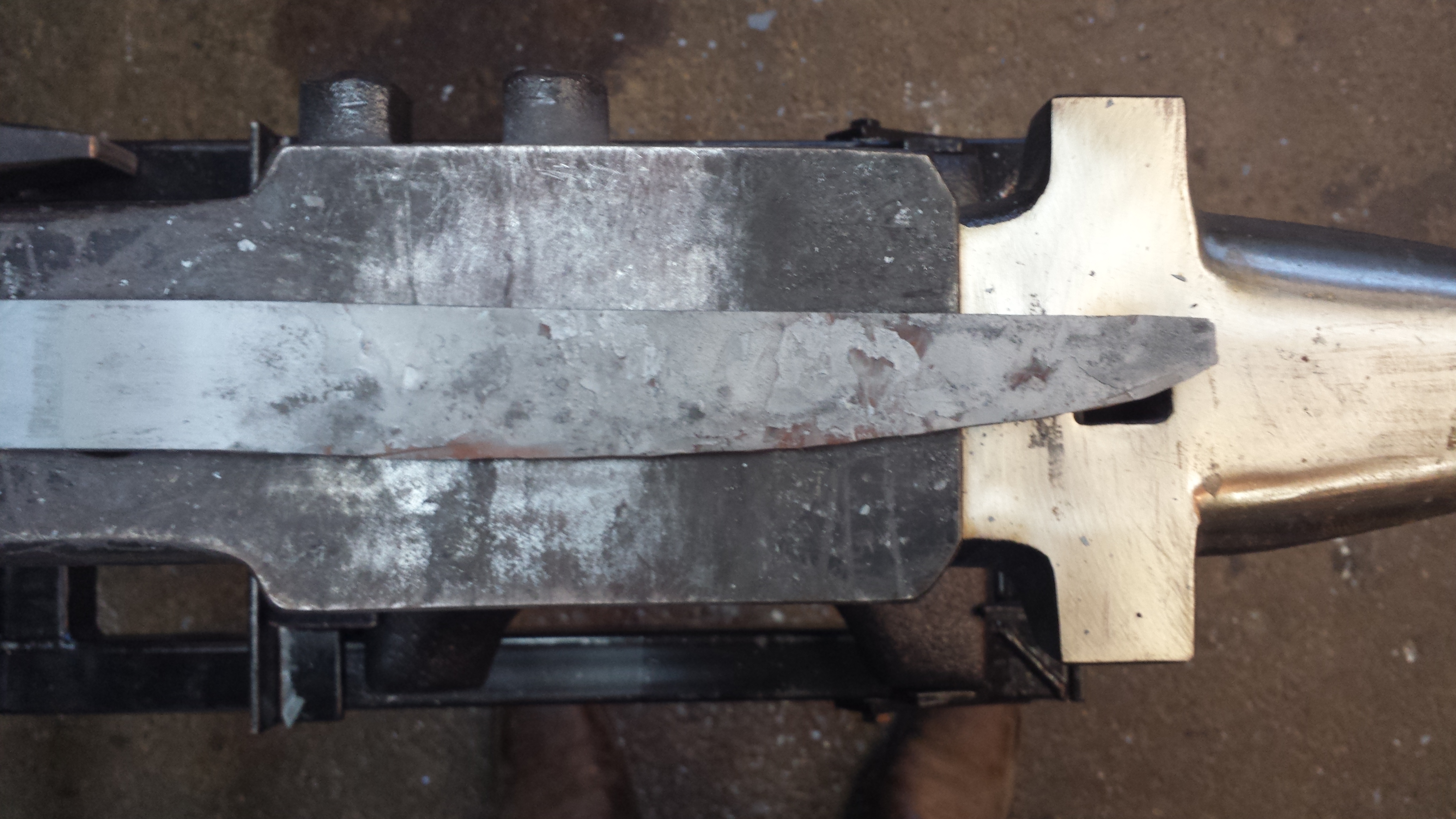

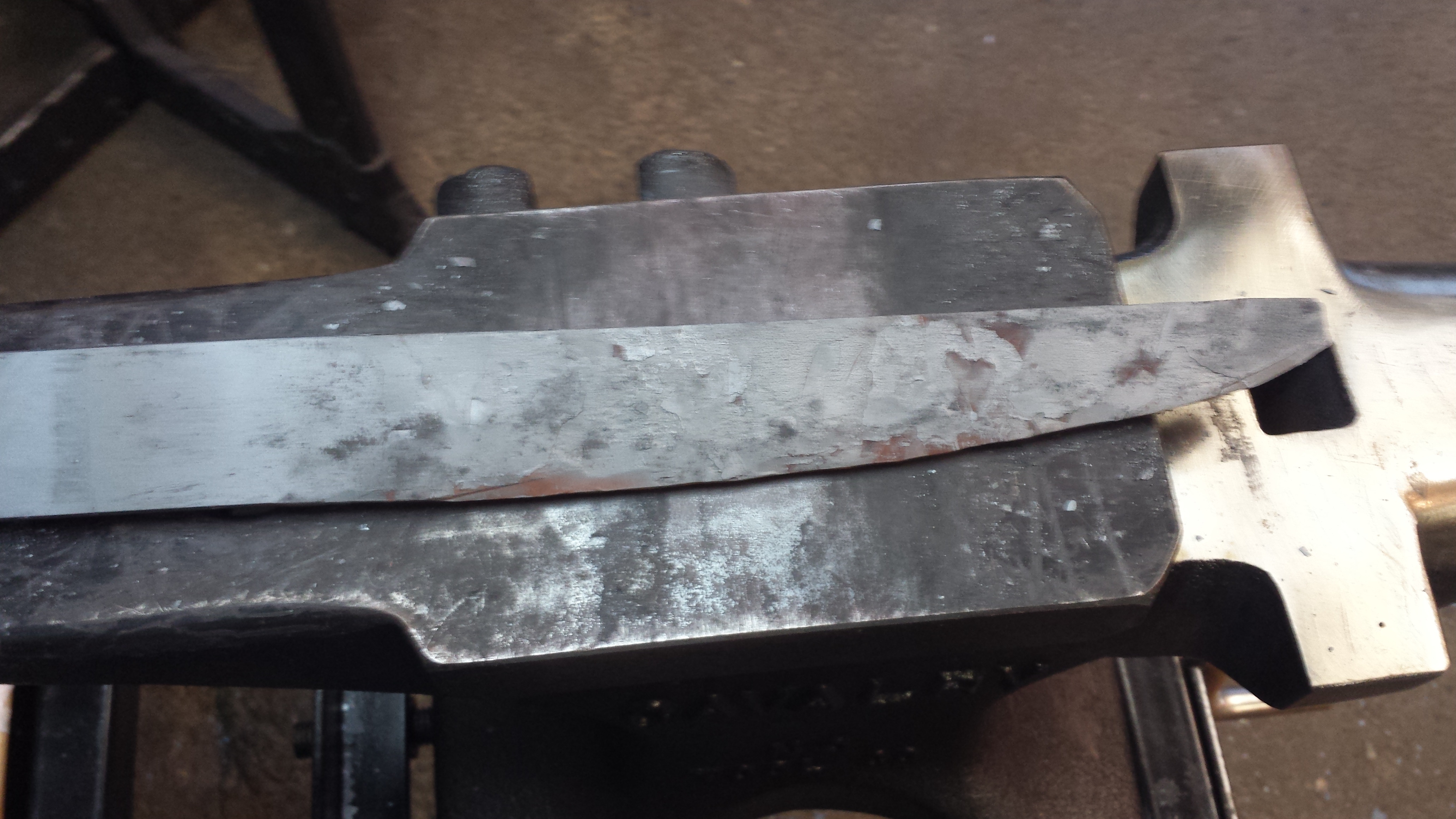

Good Evening,
I just got back from the forge and wanted to post my second attempt at a blade. It is very clear that until my hammer hand and arm increase in strength, hammer control will be a bit of a challenge. I tried to follow the advice that was give to me on this board. It will be easier to follow to the letter when that pesky hammer control gets better. Below are a couple shots . I just want to make sure that I am on the correct track.

Lookin pretty good!
When you forge in the tip, you want to hang the end of the bar just barely over the edge of the anvil, maybe around 1/4" give or take, and to forge the point, you hammer on the top corner at an angle and back towards yourself, not downward and away, otherwise you'll end up creating a "fish mouth" where the end of the bar forms almost a "U" shape instead of making a clean point. You're basically upsetting that top corner of the barstock, then hitting it flat, then upsetting it towards yourself again, then flattening again and so on.
