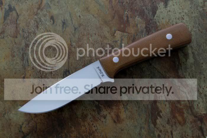

I finally got a little better camera and I have been playing with it. I don't know if it is my computer screen or what, but it just doesn't look right to me.
How does it look on your screen?
I know that Jim Cooper had a thread somewhere on photography, but I can't seem to find it. Any help would be appreciated.
Thanks,
Robert

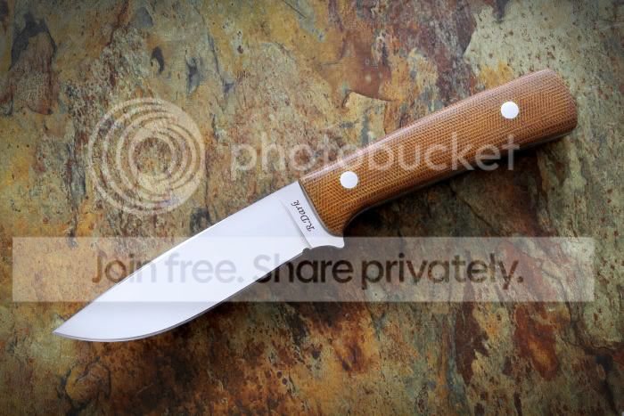

seems to have a blue cast to it, I removed it in this copy.

Other than the afore mentioned color cast, which is easy to remove and almost always necessary to some extent with digital photos, the only thing I notice is that the lighting is a tad bit flat.
You could either fix this in Photoshop or some other editing program but it's always better to do as much before you click the shutter as you can.
I think you're exposure is spot on, just the lighting needs a tad bit more contrast. Now this is where you will have to be very careful as it's easy to get hotspots as you start cranking up the contrast. Hotspots are of course a major no-no.
Great looking knife by the way.

definitely need another light in the front, then you'll be able to make out the liner and tang detail in the handle and get rid of the shadow in front of the knife.
I'm still trying to figure out this photography thing too but I will add my two cents.... Needs more light, I think it looks a little flat...like you took the pic straight down.

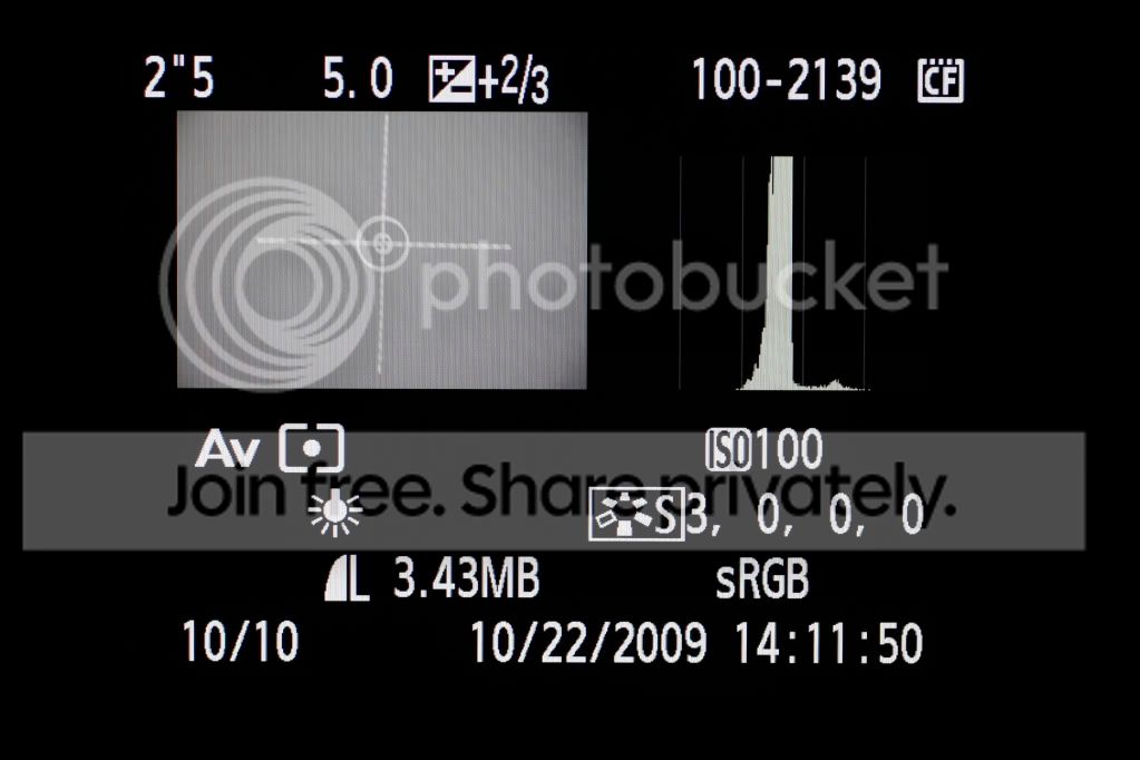

That photo is really close. Clear and descriptive. The shadow under the knife can easily be lifted using a reflective card in front of the knife. Other than that, it's really just exposure and white balance that are a little off.
When setting your exposure, keep a close eye on your histogram (expose to the right). You want the data as close to the right side as possible without clipping you highlights off. The reason for this is rooted in the differences in our perception of brightness versus your camera sensor's perception. Our eyes are logarithmic, while sensors count photon exposure linearly. Because of these differences, more than half of your data is in the brightest 10% of the exposure scale. By pushing the exposure to the right, you ensure you have the best signal-to-noise ratio to work with in post. Never mind the fact that it looks bright on the camera screen, you'll be fine-tuning your exposure later in software.
Now that your file is exposed properly, import it into your RAW editor. This will allow you to perfect the image in terms of exposure and WB. First bring the exposure down to where it looks best (your file is probably slightly overexposed to begin with). White balance is much easier to adjust with a RAW file on your computer than trying to get it right in camera. You can either use the eyedropper tool on something neutral colored (often the blade) or you can adjust the sliders until it looks best. Adjusting these properties on your computer allows you to fine-tune each image until it looks perfect. Control over the final image is vastly improved by using computer software instead of in-camera programming.
Thanks Rat. Your version sure looks better.

NOW.... I have to work on that "Flat" look and shadows. My camera will shoot RAW, but I have never tried it. It also has the histogram, but I still don't understand all I need to about it.

Your edit looks much, much better, however, I can see that I needed some reflective light back onto the bottom portion of the handle and blade in order to show more detail and reduce those harsh shadows.

YOU CAN"T FIX FLAT LIGHTING IN PHOTOSHOP
Now that I got that out of my system. Your exposure looks good, your whitebalance is a little off. Use black and white reflectors to control your shadows and reflections. A black card or fabric will add a black line to a specular reflection to give a natural looking outline. Experiment.
