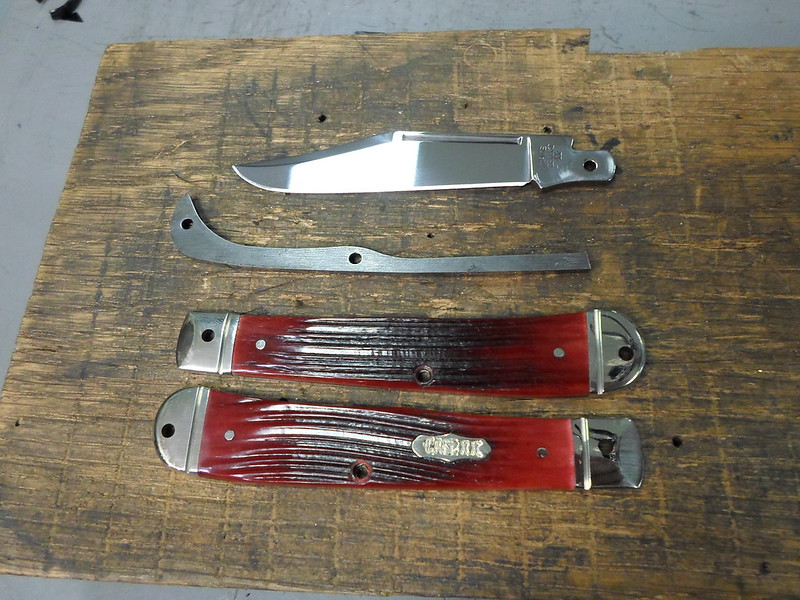

Hello All,
I picked up this Case Select '54 trapper today. It has a lot of nice features and the color is really nice in sunlight. I have not been collecting very long but I have not seen a long pull Case trapper before. I had to have it. I am not a big fan of the second blade so this knife is already apart and once I turn down some nickel silver pinstock and mill the liners, It will go back together and in my pocket. I hope you like my amateur pics.

I am really interested in such conversion, I had yellow Case trapper but it was too thick for my taste and the second blade was useless for me. How to remove and replace pins? What kind of tools do you use?

Hello Cali. I used a very short countersink drill bit to drill center pin then finished with dremel with a very small burr to weaken what is left of the pin. I taped up the knife to protect the finish and held breath while driving pin out with undersized punch. I definately did not want to crack this bone. This is the first big trapper I have taken apart and the pins are really big and not a standard size that I have. To replace I will make correct diameter pins, then peen and the center pin will be spun using a spinner tool that I made. It is held in a drill press and gives the pin a domed finish like you see in the factory knife....In theory :)

Thank you for the descriprion. It is pretty complicated and a lot of specialized tools are needed :( Good luck with finishing it :)
Are the pins made of ordinary nickel silver?

Hello again Cali. I left out the step of cutting the pivot pin and end pin. I take a thin butcher knife I bought at a yard sale for a dollar and place the knife to be taken apart on its back edge with blades open. I have a chunk of hard oak that I set the knife on to minimize damage. Try to position the edge of the butcher knife in between the centerliner and spring end of the pocket knife. In this case I picked the centerliner and the spey spring end so I lessened the chance of scratching anything to do with the main blade. Then tap the spine of the butcher knife through the spring end pin. Hit it hard enough and it will cut the pin. Do the same for the pivot pin. If it is a real nice knife, the main concern is cracking the bone. And yes it looks like standard nickel silver but a oddball diameter.
I recommend giving it a shot. Maybe try it on a junk knife, just to see what kind of force is needed to take it apart. Regarding the butcher knife, try to dress the edge between uses because it creates quite a burr that can ruin a liner if you plan on using it again. The tools I used to take it apart are very cheap and easy to get. And if you were to use smooth scales such as smooth bone or wood, you dont need the head spinners.
