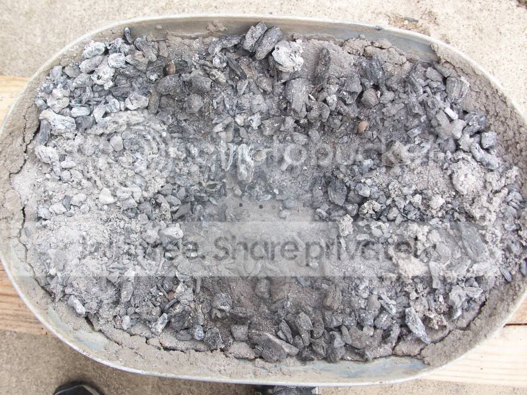

First I made the adobe which is half sand and half cheap kitty litter with a handful of wood ash. I mixed water in until it was well mixed and similar to wet concrete.

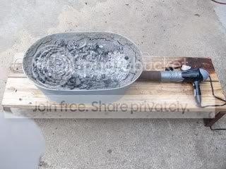

I cut a hole in the side of the washtub for the air pipe, which is used oilfield pipe about 2.5 feet long with holes drilled about every inch or so. I also welded a plate on the end of the pipe rather than have it go all the way through the washtub. I know i'll just have to take off the blower to drain the ashes.
Once the pipe, washtub, and adobe were all in place it was a waiting game for the adobe to dry. it took a good 3 weeks in my garage but once it warmed up I sat it outside and it dried quicker.
The blower is a $11 hair dryer from Family Dollar.
It fired up nicely an heated evenly. I used charcoal I made from oak. I went through about 3/4 of a 5 gal bucket of charcoal in about an hour.
I look forward to getting it going again this weekend if the weather permits.

The tub won't get hot enough to burn off the zink. I've used an identical Tim Liveley style forge for a few years now. Still, be careful.
Yes, don't worry too much about the zinc burning off. I have heard of smiths picking the forge up by the sides and moving it ...while there are coals in the pan. The outside doesn't get hot enough to worry about the zinc.
Stacy
It is galvanized and I hope I put enough adobe in it to insulate it. I didn't think to touch the sides while burning but I did keep it outside with a fan to my back... just in case.
I'll check out the sides next time I fire it up and put more adobe if needed.

I had to upgrade from the hair dryer pretty quickly though. Burnt motors. I picked up a squirrel cage blower from ebay for $20. Still kicking.
