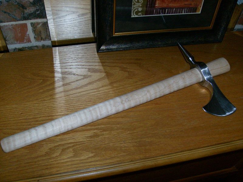

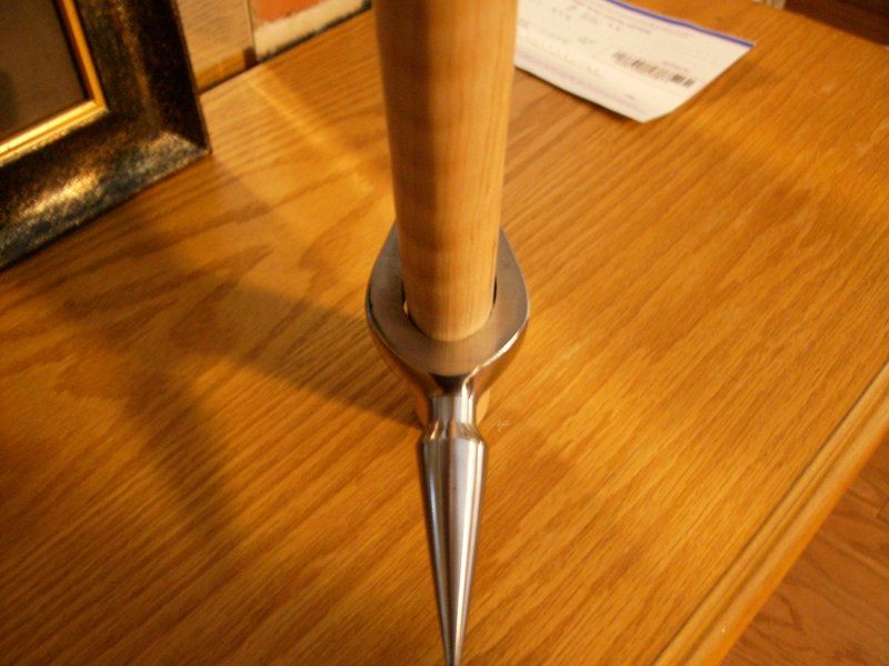

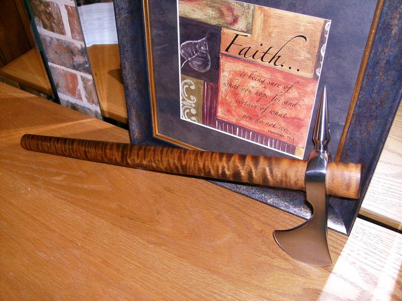

Here is pics of the curly maple. Think I have it ready for staining. The head is just pushed up by hand. Think the fit will be much better after I drive it on.
Drive it on with a rubber mallet by hitting it on top of the haft a couple good whacks. Drive it back off hitting it on the bottom of the haft their will be marks from the head where you need to sand more.
Thanks,that helped a lot. 15 min of sanding in the right places has really closed up those gaps.

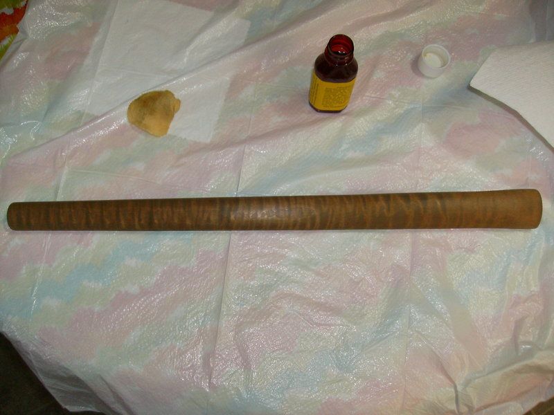

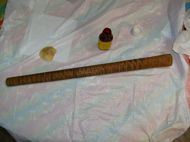

Here it is after 3 coats of stain heat with hair dryer applied between each coat and a very light sanding with a scotch brite pad. Took a good bit more heat to turn the color than it did for the guys on youtube. The second pic is after wiped with a damp cloth to get an idea of what it will look like after the oil treatment.
Looks great that's why I went and got a heat gun a hair dryer will work but takes a lot longer. Tiger maple is some gorgeous wood.

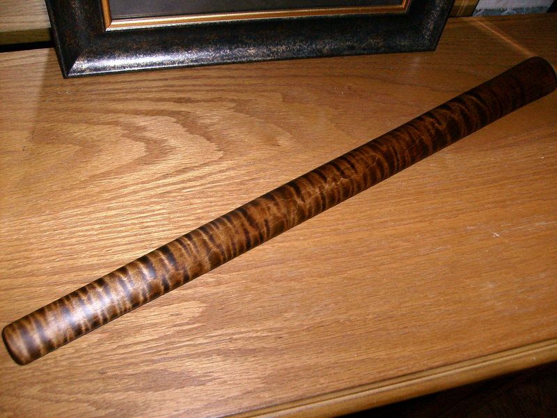

Here it is after one good coat of BLO. Not sure if I am going to do any more coats if it darkens with more coats. The color is dead on where I want it. How long should I let it dry before the wax and is there any other prep work before wax?
Big difference huh I let it soak in for at least 24 hours depends on the weather.

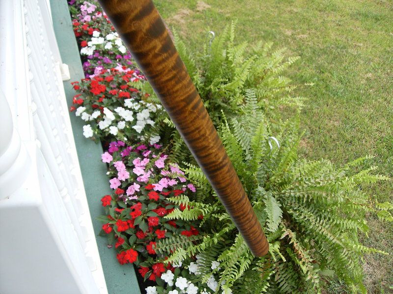

I am very pleased with the grain. This was a 7.00 haft,wonder how good one of the 40.00 ones would have been. Got to keep the head shiny.
All waxed up and finished unless I decide to tie a leather wrap under the head. Thanks for all the help. Think I will do another soon only it will have to be a Cold Steel next time.
