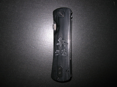

i acquired a modified one from a fellow forum member who milled out the g10 removing the kanji and giving it more texture. he also removed all markings from the blade. when i received it all i had to do was finish mirror polishing the blade and the thing is pretty sweet now.
it deploys with authority albeit learning how to deploy it effectively with the thumb disk has a bit of a learning curve.

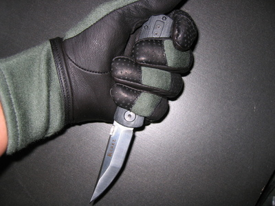

On all of the examples of the larger one I handled it was easier/faster to open without the spring assist. The Hissatsu 2, on the other hand, was easy to open AND close with the assist in it so I would probably just leave it in even though I'm usually pretty outspoken against AO mechanisms. I wish they had an option for one without the kanji on it, but regardless it looks much less "mall ninja" in person and much more "gentleman's knife". As a whole it's an excellent value and I would love to own one personally. It's an attractive little package that carries easily and cuts well. :thumbup:
