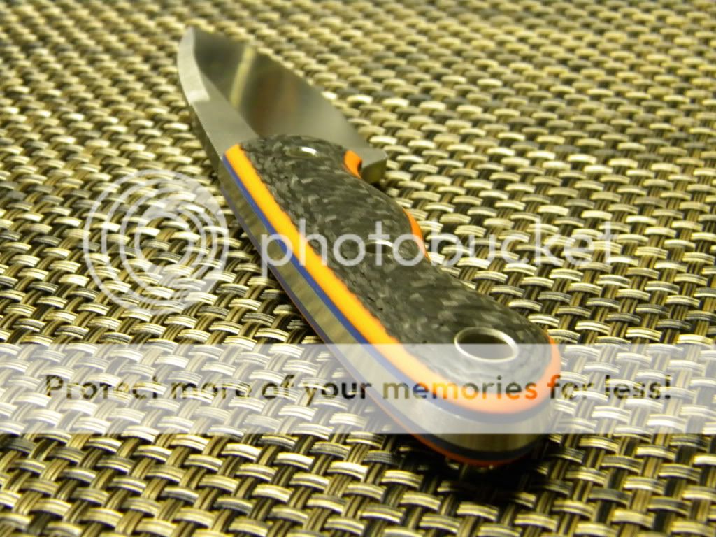

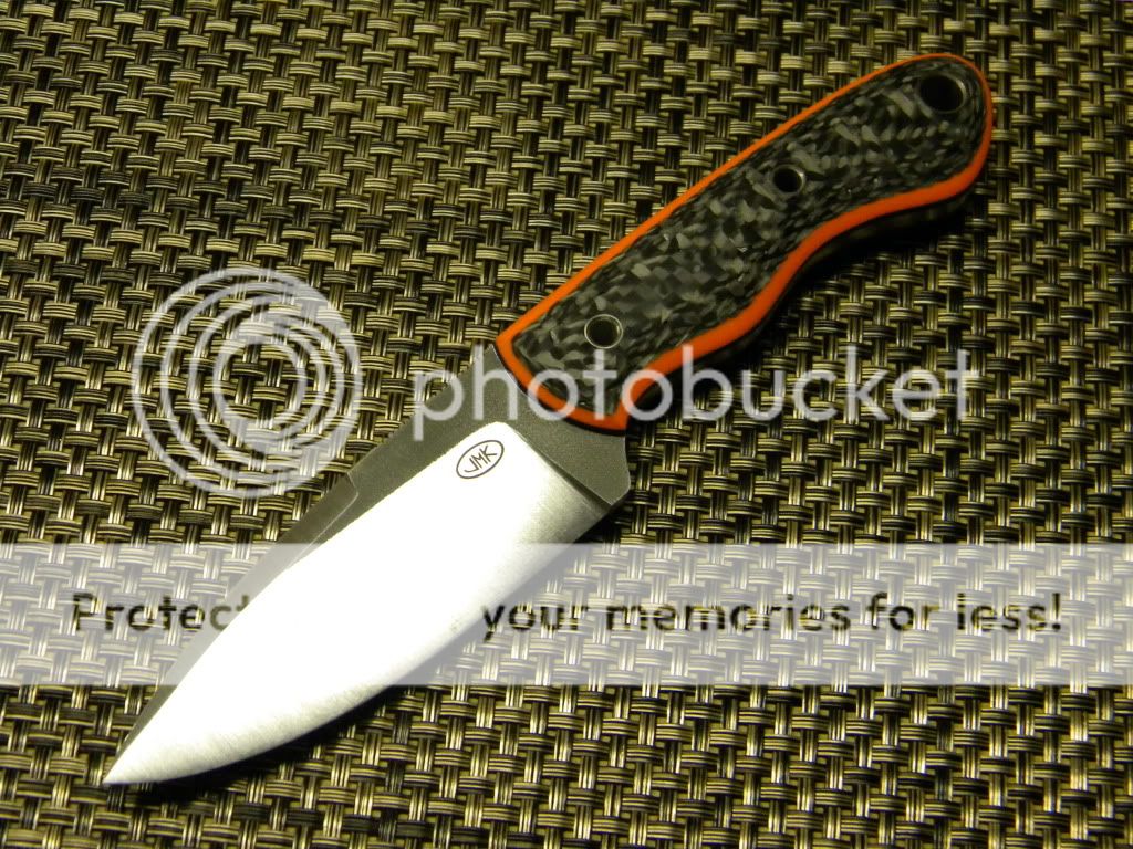

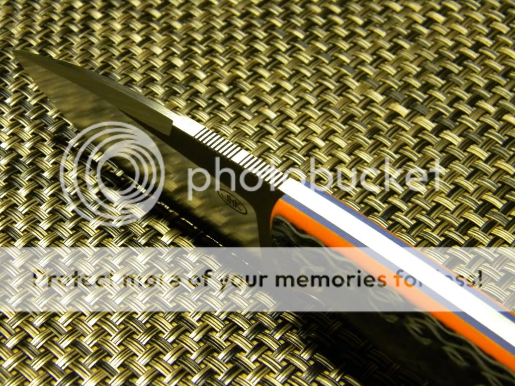

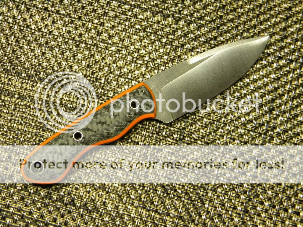

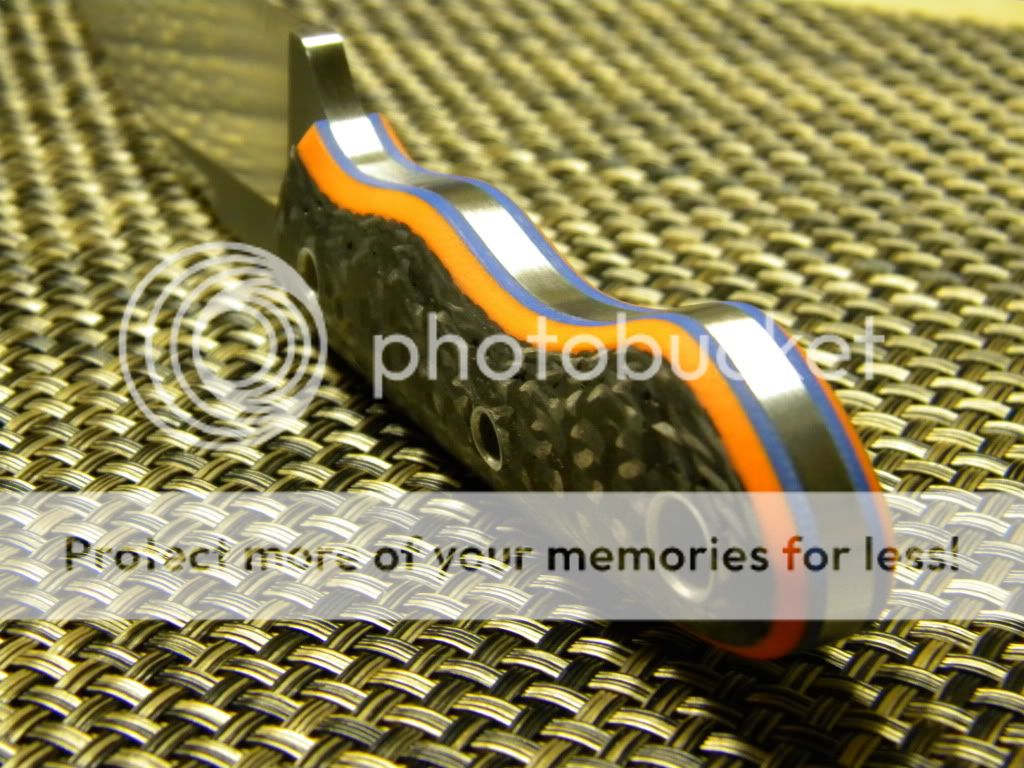

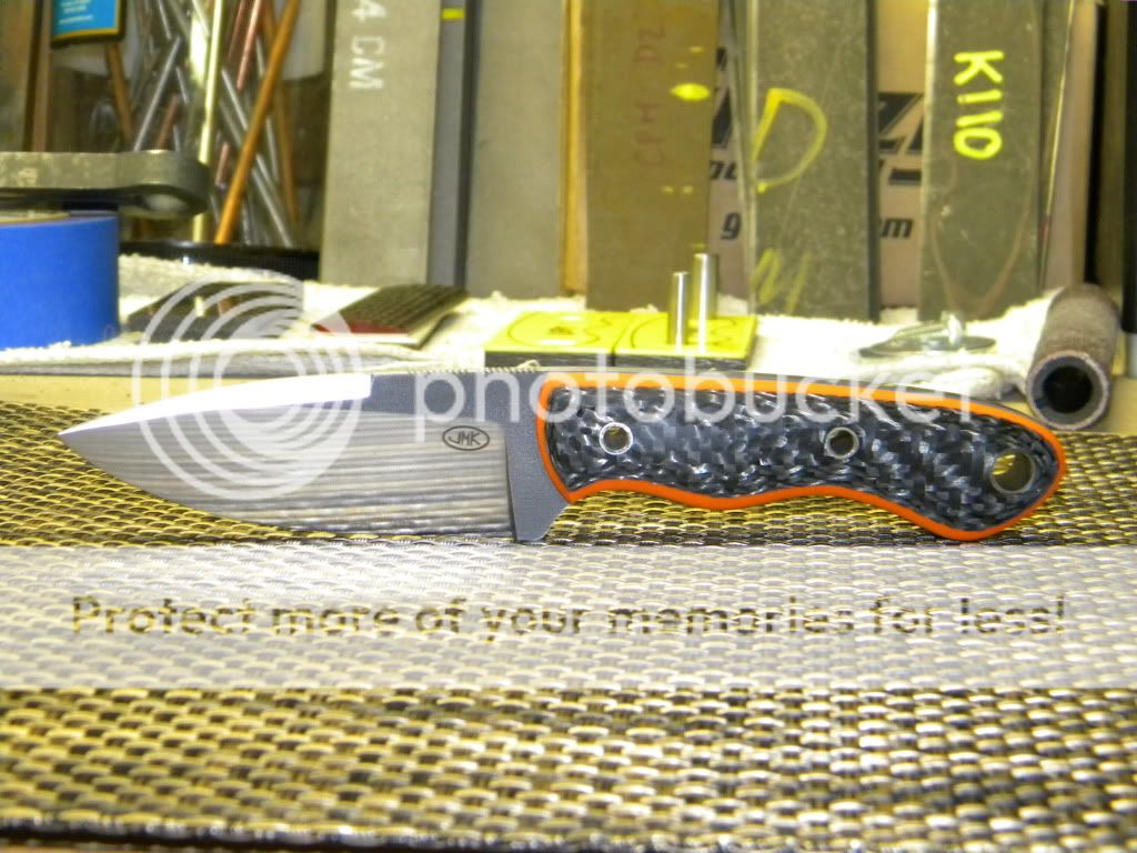

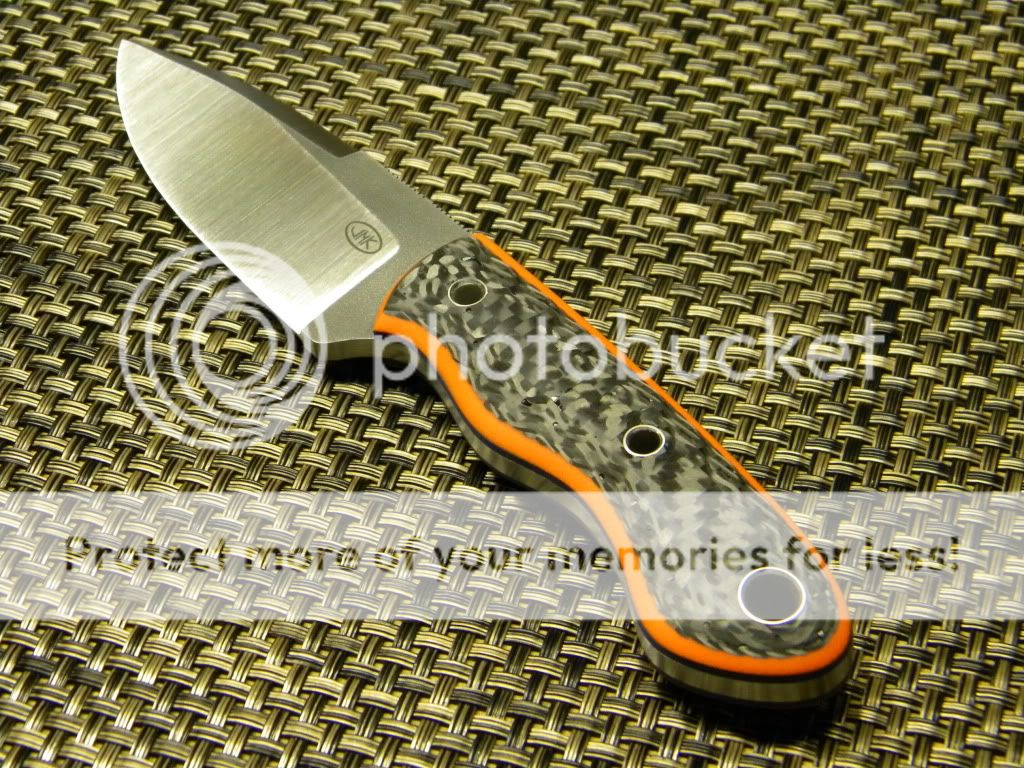

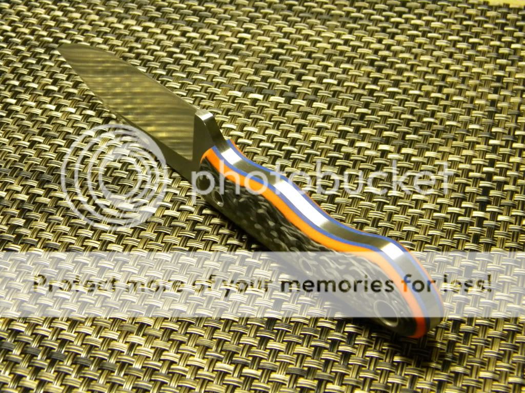

Here is a new design I came up with recently. I've got a batch of these in the works in .178" thick D2. This is the first one I finished up. Flat ground, heat treated to RC 60-61, satin bevels, acid washed mill scale flats, carbon fiber over orange and blue G-10 liners. It's the subject of a big WIP thread I did in the shoptalk forum.
Thanks for looking, comments are welcome!

best looking design I've seen come out of your shop so far.

Geeze Jon, am I gonna have to put an order in with ya?! Thin that thing out and I'll be knockin on your door in about an hour to pick it up!

The only thing that I really dont like about that knife is its not mine!!! (sorry I had to)
Great job man I really like the huge flat grind and the profile of the whole knife is really sweet. Did you flare the hollow pins?
