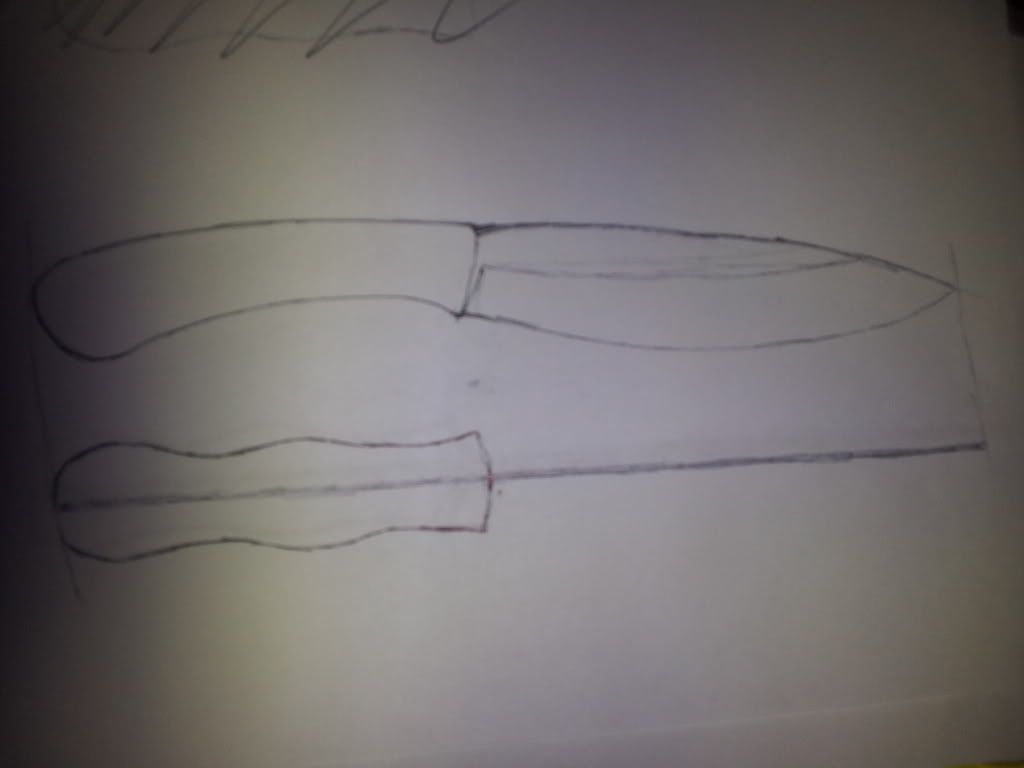

Ok so I looking over what has been posted I drew this quick sketch of what i envision you knife looking like. I could be completely off...what do you think?
maybe a little to much swell at the bottom
Alan, grab a file and go to work! Nice one my friend. Since I want an all around woods knife I am going to have a straighter handle. That one would make a killer comfy skinner though! The Willow blade is just so dang purdy isn't it
Its also opposite of what I was thinking. My drawing is not the thickness profile but rather the actual profile.

that is not necessarily how thick I would make it, but it was the best way I could visualize the shape/profile. I feel like thickness is one of those things you kind of have tailor to each individual knife. I haven't made a handle before so i can't say for sure how thick I would make it:confused:

my 2 cents for the hell of it . I like Alans drawing except for the dip on the spine where the handle meets the ricasso ( you know me Chris ) . Also , forget the palm swell , a rounded fat handle egg shaped , fatter at the top-thinner at the bottom .
Also , I like the wife's . My wife has a syderco folder with the same blade shape .

Chris, I've always liked a willow leaf blade. Yours looks to be coming out nicely. You seem to already have a knack for eye-pleasing, comfortable handles and I've no doubt this one will turn out terrific. In my mind's eye I've always pictured one with a handle that begins slightly wider than the blade, then slightly tapers in symetrically to the mid- point, then back out to the butt; in two opposing concave arcs. From their apices, symmetrical convex curves would delineate the butt and the front end of the handle. Some palm swell on the dissecting plane would give some amazing purchase while preserving the versatility of grip choices. I guess a coke bottle with the same size neck as butt Lol, just sticking something into your subconscious there.
English man, speak freaking english!
Chris, make the knife how you think it will feel and work best. So far I like the profile, simple is never a bad thing.
By the way, you're wife's knife has some great curves to it. That rear curve in the handle looks oh so comfy!
