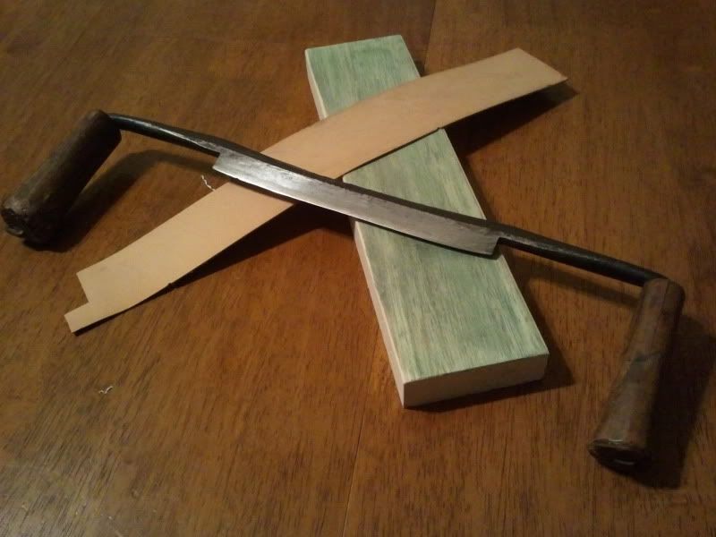

I posted this over in BRL's forum as well, but I know there are a lot of tool collectors in here. Maybe one of you guys might be able to help me figure out it age and maker.

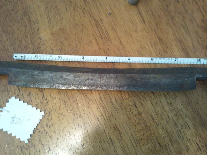

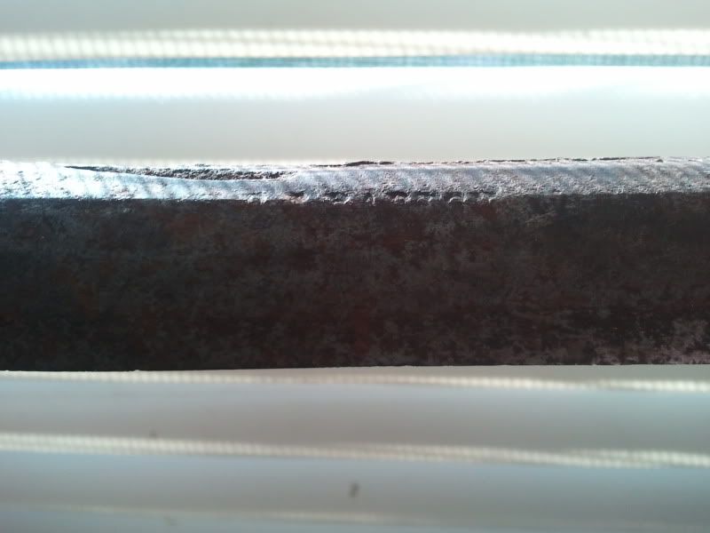

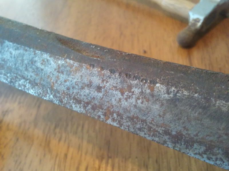

I just picked up this draw knife at the flea market today, it has a forge welded bit to a softer frame and appears to be original handles. There are remnants of a stamp on the frame, but due to sharpening it is about half gone. It is single bevel and a 7.5" blade.

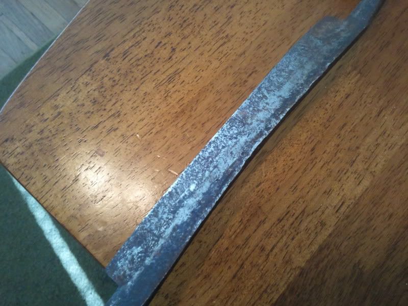

This is the back side

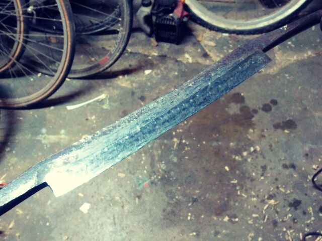

Top side of bit

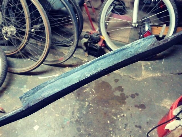

Remnant of stamp appears to be two letters followed by a name. You can also see the weld line about 1/4" up from the edge.

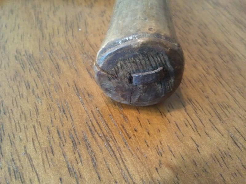

Here is the handle construction, the tangs are forged down real thin and hammered over.

.... it has a forge welded bit to a softer frame and appears to be original handles.

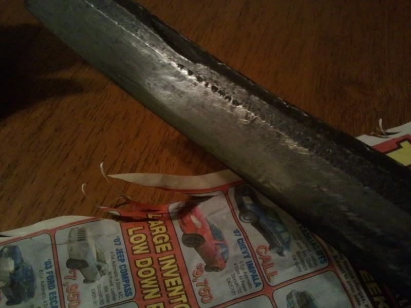

Well I got it cleaned up and sharpened. I didn't take the edge back to try and take all the chips out, I figure they will sharpen out over time. It is a beautiful tool, well balanced and fits the hands well.
I started with an oil scrub using #0000 steel wool all over to remove the active rust and allow the oil to soak in to better protect it. Once I got it cleaned up I started with a medium diamond stone hand held so I didn't take off too much material. Then I switched to a #400 Norton oil stone on the bench. Once I got it close I then went to a small water stone (locally harvested myself) to bring up a burr. I then switched to stropping for the final stages, Cr02 on balsa to start then finished on plain leather. Pretty darn sharp now! Slices newsprint pretty well, between the chips. Sharp enough for me!
It also turns out that this knife was likely sharpened with a file or small stone, there is a fair bit of crown to both sides, less so on the backside but its still there. It should help a bit when working bevel side down, though.

I need to take a close look at the right side handle, it has a split in it that may be an issue with hard use, I need to decide if I should put a seizing wrap on it, or try and replace it. It is the handle in the pic on the first post, that crack is the full length of the handle.

Looks like your assesment was confirmed, I sent an email off to Tom at yeateryearstools.com asking for info. This is the reply I just received:
" Based on the pics and what you describe I would say that the drawknife was early and before Mack & Co. Not all drawknife handles included ferrules. but based on the appearance of the handle end I would agree, they were probably replaced. The type of tang clinching also indicates that the piece was early.
Hope this helps.
Tom"
So this appears to be pre 1875! Much older than I originally thought. There is a timeline for the companies under D R BARTON over at the Davistown museum website.

I would fill the gap in the handle with glue. Woodcrafters here and probley most hobby stores have a super glue that you can get in three different viscositys. You can also buy a excellerator to make it set faster that you don't need. If you can wedge that split open just a little bit and fill it with glue you are good to go.
Actually, the crack is open about 3/32" the whole length. A little more than just CA glue is needed, which is why I was considering a seizing wrap. I can squeeze it by hand and see the crack close up a little bit. I'm thinking some 400# dacron cord in a turks head will look nice and when I draw it up will close the gap. We'll see what ends up happening with it. If I do replace it, I have a section of bois d'ark fence post that would work very well and is likely close to 100 years old.
