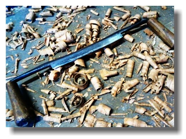

Putting the drawknife through the paces today. Got a piece of pecan and am going to try and make a hatchet handle. Some tough stuff, but it seems to be holding an edge well. Handles are fine for now.
-Xander

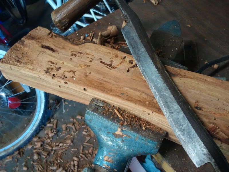

Uh oh, looks like I got a live one! Wood borers in this billet, but looks like they are fairly fresh to this chunk, not going very deep, lots of grubs in it. A little more hewing and shaving should get past it.
Just one little hole is all that's left at one end, that will be the butt. Working through this billet makes me long for a hewing hatchet, all I have is my 3.5# mexican full size axe and a cheap little tomahawk. The rest of mine need handles, so I might as well just push on through the pain in my hands and forearms to get this done.
-Xander

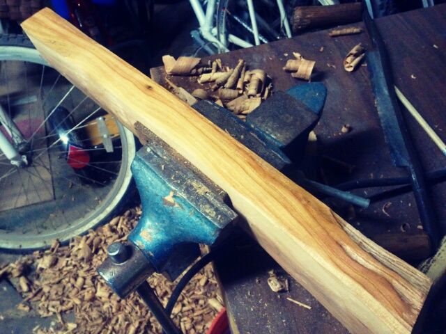

The shaving pile is growing...

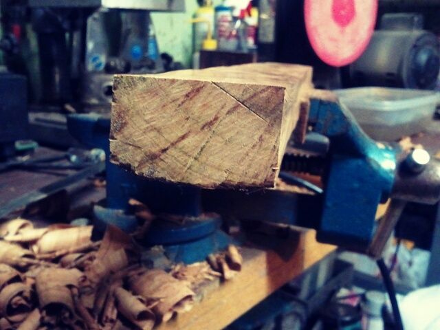

The billet I chose has a slight bit of twist to it, but no real runout. The right side of frame is the but of the handle. It should be absolutely perfect for my little 1.25# hatchet with a hamon. This billet is just a hair over 15" long, bout perfect for a 22oz head I recon.
A nice side effect of using a draw knife is I get to keep warm on this cold night of 28*F(a hipster of rum sure helps too! :thumbup:)

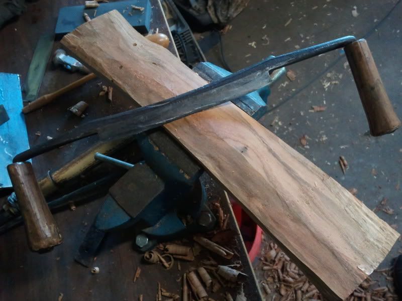

Getting closer...
After truing it up I will draw my pattern on and go from there. Time for bed now, gotta get up in a few hours and get back to this!
