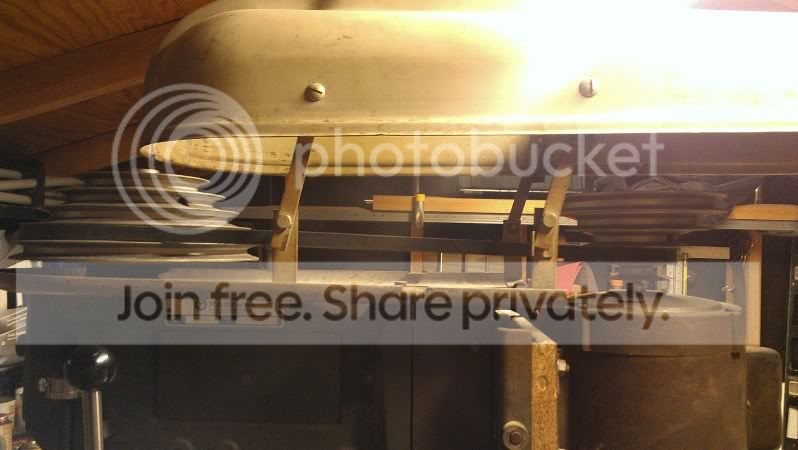

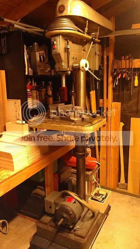

I had a question on an old Rockwell 17-600 that I picked up. The main drive spindle is about 3/4" lower than the front spindle, so the belt is angled a bit at each step. No machining experiance, so not sure if this is normal and couldn't find any hits online. I don't have a chuck ready just yet but it seems to function fine with no load.
Some day I'd like to use the original motor, but until then would it be OK to use it as is? I don't want to cause excess wear or damage the press.

Well you got a gem there. Those are very nice machines and your has a production table on it as well. As for the belt issue a picture from the rear would be helpful but you should have a set screw on both the front and rear drive pulley/shive it will be located in one of the pulley groves. When you loosen this you should be able to adjust the hight on the two to make them run parallel.
Most drill presses of that size have 3 pulleys and two belts.
Maybe you lost the center pulley ?
Brett is right about the setscrew, you should be able to make adjustments.

Not the ones I have seen Count. Mine has two 5 step pulleys. With quick adjustment to the pulley you will be fine. Check Enco or Shars for a low cost chuck but don't get there cheapest one.

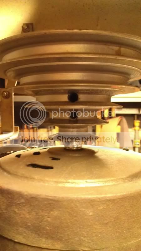

So it appears Bubba did a bit of work on the motor shaft. Looks like some metallic tape was used to wrap around the shaft. :(
Also the top of the pulley sits about 1" above the shaft, so no much room to raise it any. Did some searching last night and found a split bushing may help for this???
I loosened the set screw on the front pulley, but it wouldn't budge after some light persuasion, so I left it alone for now. It actually looks pretty well bottomed out and dont see it being able to lower much if at all.

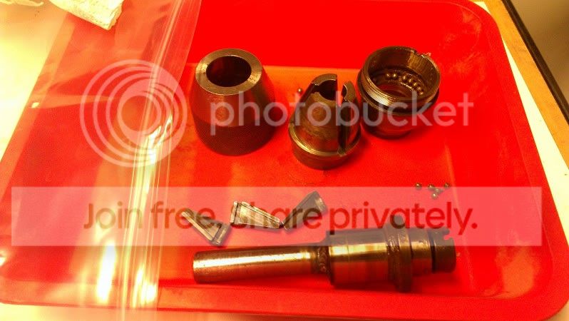

I'm waiting on a body/spindle assembly from Albrecht to fix this guy up. Someone thought it would be a good idea to weld a straight arbor to it.

Well if the guy who welded that shaft on there knew what he is doing that might of worked out but Im betting you got some run out with that chuck.
Also two easy thing for the belt. #1 is just skip the lower pulley on the motor and go starit accros to the bottom drivin pulley you will need some belt adjustment. #2 is remount the motor on the higher on the motor base plate.

I would not worry about it too much. The small amount of slope that you have will wear the belt a little faster but it isn't like the v-belt running the fan in an older car. It probably isn't under high tension and doesn't need high tension for the job it is doing. The slope in the belt puts a very small lateral load on the pulleys (acting along the axis of the shafts) but that is so small compared to the load acting perpendicular to the shafts.
