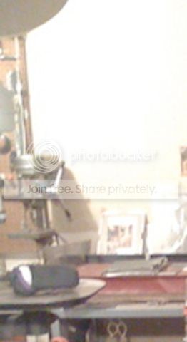

Cropped from an old larger photo the drill press was in the back ground.
It just so happened that the big drill press table is in the fore ground on the left and it almost looks like the little one is sitting on that drill press table.
