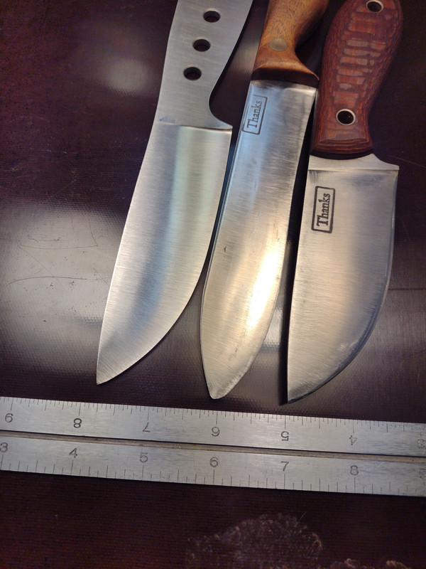

That particular one is just less than .070"
It's surprisingly ridged for as long and thin it is. It will absolutely Not take a set when flexed, Ever.... Most certainly could break with how Hard it is 64-66HRC, but wont take a set. It would snap.... haha.
It's hard to tell, but I have what I call a shovel tip on it. (I'm not really known for super pointy knives) It's Very sharp at the tip, just not pointy
But she Will take a pounding for sure... When this picture was taken I was grilling outside, early this last Fall/Winter. I went out on the waters edge and stabbed through over 4" deep of ice. I made a hole big enough to stick my arm into the water.....Even though this steel is brittle, it's Tough too.
I don't really like thick knives anymore. I used to, but I currently don't. Thin wins!
5/32 is about as thick as I go. Most are around .125"
I usually like Tough steels. My opinion is that why use fancy, tough or high alloy steels, and have thick edges on them? Seems wrong.... :/

Hahah.... I wouldn't of mentioned it If it damaged the point... 😂😂😂
(there was no sign of damage)

As you can see the middle knife is set up with a more rounded tip compared to "normal"
No dents, chips, or rolls.....
