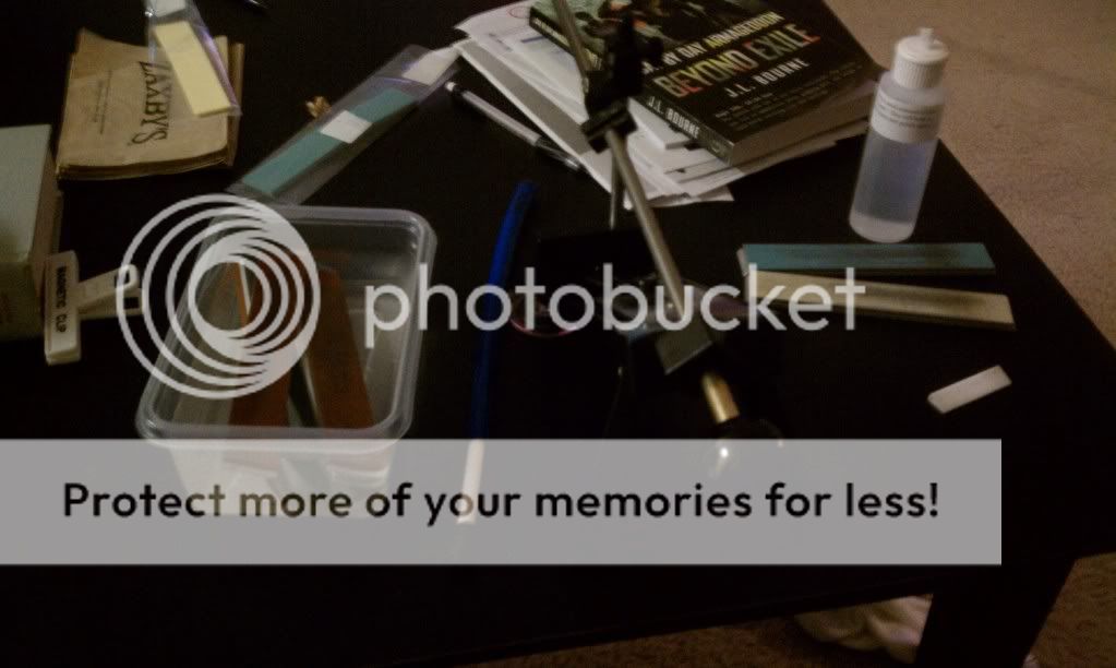

Woohoo! Got the Apex 4, I'm diggin' it. Here's my first try.
Before:
After:
The setup:
The knife did a lot of moving because I reprofiled the edge a bit, so the mirror finish isn't there like I want it... But MAN this thing cuts like a laser.
