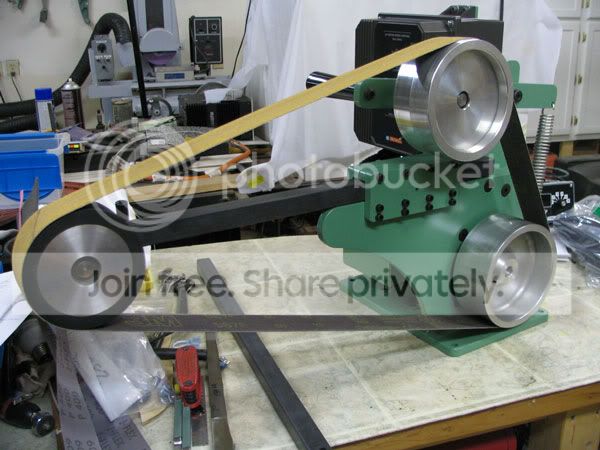

A few months ago a new grinder kit was offered in the makers section and the offering went down hill pretty quick. Here is the link to the thread.
http://www.bladeforums.com/forums/showthread.php?t=675343
Starting about page nine Chris Williams (blindhog) stepped up and volunteered to produce a set of CAD files from photos of the grinder that had been offered.
After a few mods Chris offered the CAD files on his website.
I found a local water jet guy and had him cut out a couple of the grinder kits for me. He likes knives so we worked out a deal:D
I would like to thank Chris for all his hard work on this project.

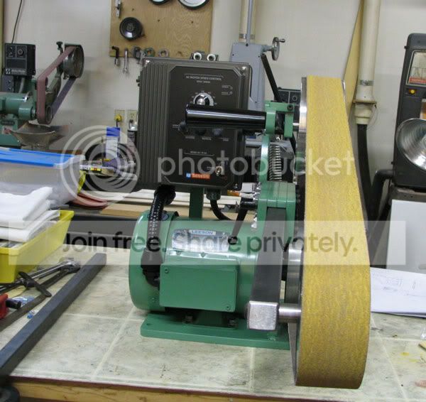

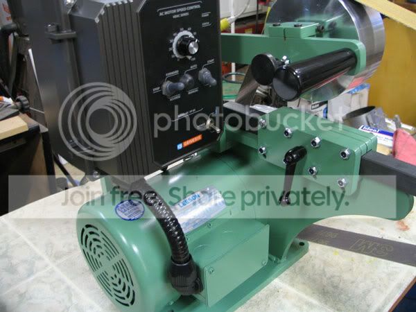

I used Bader wheels on this build and an ebay 1 1/2 HP motor and a KB Electronics Drive.
If you would like one of these kits polarbearforge is offering the kits here.
http://www.bladeforums.com/forums/showthread.php?t=720299
Thanks for looking.
Charles

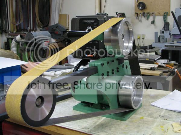

I noticed you have the original plans before the hole for the work rest. Looks very nice and clean! Where did you get the 6" drive wheel?
Wloch
This the original EERF grinder design, the one with two tooling arm slots is a variation Jamie at polarbearforge.com came up with. If you go to my website and download blueprints or get cad files it will be the above design.
Charles it looks great, glad to hear you were able to work out a deal on getting the grinder cut. Love the 6 inch Bader drive and tracking wheel on it. Also like the mod to take 1 inch tooling arm.
Chris

What was your final cost for the machine?
Just a rough idea
$300 water jet work (The quoted price)
$370 KB Drive
$60 New ebay motor
$156 Bader 6" drive wheel
$150 Bader Idler wheel with bearings
$85 Bader 4 1/2" contact wheel I had this already
$8 per Tooling arm

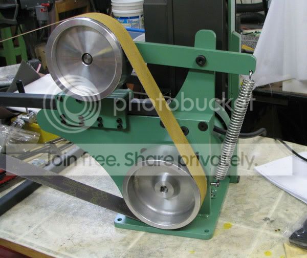

Trampoline spring had some laying around
$40 for bolts knobs and handles
$1169 +- a couple of bucks.
You can get Idler and drive wheels cheaper at Beaumont.
Where did you get a tooling arm like that for $8? It looks like solid 1 1/2" bar that is a little over 2 feet. That is less than $4/ft! Around me I didn't think I could get tubing that size for that cheap!
Chris, I realized it was the orig design because of the lack of the tool rest hole and the height, just making an observation. :p
I used 1" stock for the tooling arm, about 1/3 the price of 1 1/2" stock and it works great.
http://www.metalsdepot.com/
Hot rolled square bar 1" x 1" $7.64 now you have to pay shipping, just get a bunch of stuff you can use in the future and the shipping per piece isn't to bad
I noticed on the Metals depot website if you order the 20 feet (The longest bar size) and have it cut to UPS shippable size you save 25% off the top.
Its still cheaper for me to buy locally but that is a good option if you don't have steel near by.

Can you give the specifics on the KB and the Motor?
Also, how you picked the sizes of the wheels?
Thanx!
Nice job!
Thanx!
KBAC-27D
http://www.kb-electronics-controls.com/_product_15403/9520_-_KBAC-27D_Gray_Inverter
http://www.kb-electronics-controls.com/files/manuals/kb/9520.pdf
http://www.kb-electronics-controls.com/files/datasheets/kb/9520.pdf
The motor is 3 phase.
the combination of that motor and controller give variable speed

12345678910 was correct with his links for the controller, Thanks 1-10
The motor is a Lesson 1 1/2 HP 3 Phase C face totally enclosed fan cooled motor.
The drive and tracking wheels are standard on Bader Grinders, I like the looks of the larger wheels so I went with them. If you get your tracking and drive wheels from Beaumont you will save some $$$

Another quick question about the wheel sizes.
The reason to have 6-8-10-12-14 inch contact wheels is because they cut different profiles? Is that right?
I was thinking for a killer setup to get both Platens.
The Multi with a 10" and a 4" maybe.
Then get the standard with 2 different sizes Poly Contact wheels, maybe a 2 and a 3".
Can that be done and does that make sense?
That way every wheel would be usable as a flexible and different profile grind point?
Then obviously the SW attachment for the Ultimate variety.
