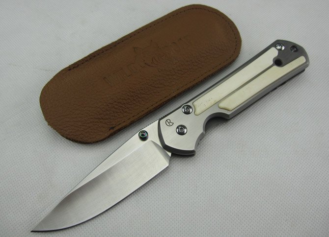

fake camel bone inlay

fake camel bone
back
just to shw the difference, this has bad grind, full lanyard pin, detend ball hole, smaller thumbstud hole

earlier we had the sanrenmu seb, few usd and SRM logo, now there are these "high level" fakes, in D2 and Ti, more difficult to spot
pricey for a fake.
yes,
they have higher prices than usual chinese fakes, but, as above they're more accurate fakes, hence the higher cost I assume (?)
being more accurate makes them even more dangerous
149 for a ti lock
50-60 for a seb
89 the customized seb
100 an inlayed one

the bloodwood seems to have a rather thick framelock, or is the large so thick? that could be a hint for the fake
anyone with a large/inlay to chime in? trying from the pics to find some differences
Maxx
I can see a few issues in the pictures from the grind, thumb stud, blade shape, and size, or more specifically height, of the inlays. While the pictures look real close, in hand and next to a real CRK the small discrepancies would be glaring to any one familiour with CRK. The problems are for people that don't know CRK or don't know what they are looking at.

As for the thumb stud color. I just received a large Sebenza from Wilson combat with double thumb studs and they are not blue. I thought that was odd too but I checked and the knife is legitimate.
