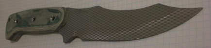

Why it is really common for many of you it is relatively new to me. Proved to be a really tough and good edge keeper.
Although the finish I put on it did not work as well as I wanted it did pretty well. Considering I was chopping on a 2x4 that was hard as a rock and has been sitting in the garage for a year in AZ heat.
Will let the pics do the Talking.
Oh BTW it is 3/16" 1095 with an Etched finish and edge quenched.

Looks like it is holding up real good Rob, 1095 is good stuff. Love that blade shape! And the etched effect seems to be holding up well.
Experimenting with a few variations on the theme. Deeper and more durable is the goal.
you need to get a vinyl resist stencil made, then leave it in the acid for a couple hours brushing it clean every 10 minutes or so. You'll feel it like a rasp then :D
I use 1095 often, and it's one of my favorite steels. I've been trying to break a 1095 blade that I differentially heat treated without success.
Nice looking knife, neat finish too.
How was that done, spray painting over a fishnet stocking then etch whatever the paint isn't covering?
