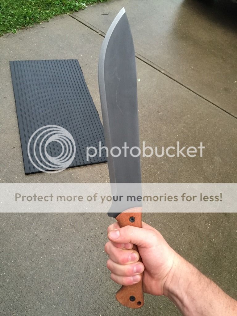

Got the first one finished up today! This is the new 12in model.
Really wanted to get the new logo on this one but the etcher was acting up :mad:
52100 for this one. Not sure on the weight. I'll measure it when I get back to the shop on monday. Feels very close to 1 pound.
