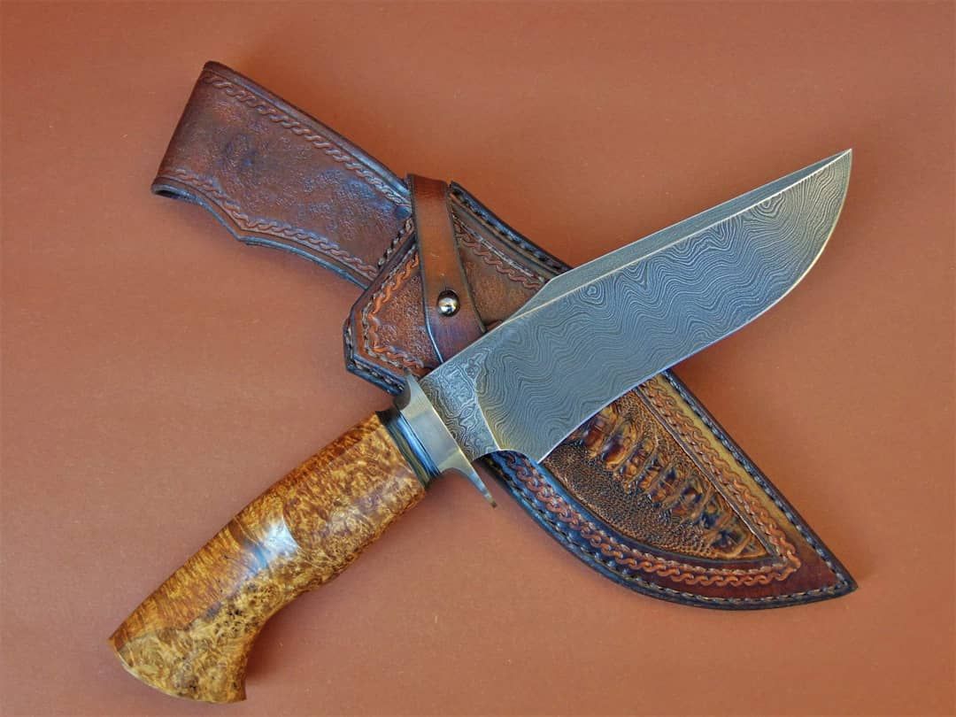

Hi everyone.
I´m make again some new knife in my workshop.
A few basics about it follow.
_The blade itself is made from damascus steel.(1095+52100+O1 steel use/400 layers)
_Blade is hardened to between 58-60Hrc.
_Handle is made from stabilized Amboyna and damascus guard.
Blade is through hidden tang knife that is tightened by a nut from the pommel.
This is then hidden with a plug of matching material.
_Sheath is made from cow leather+ostrich
Here are the dimensions for knife.
Total lenght-280mm
Blade lenght from ricaso-145mm
Thickness-6mm
Thank you all for looking
