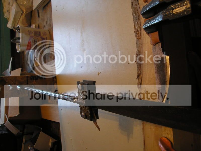

Well I don't know if anyone else has this problem but when I file a blade I have problems with holding it still and it vibrating or jumping up and down. So I came up with this solution I built a jig that can be clamped into my vice which makes it solid to work on. It's welded up out of mild black iron, the top is 3/8" thick as well as the bottom and the sides are out of 3/16". It has an 1/8" angle iron welded to bottom so it set center in the vice no matter which way it is turned. Yeah it's built like a tank but thats the idea when the blade is clamped into it, the blade ain't going to move. That allows for better file control using both hands on the file.
It kinda blends in, in the picture but there is a ratchet type 3/8 bolt on the one end (left side in this pic) for holding the handle of the blank.
On the other end I made an assortment of different lenght pieces of spring steel to use to clamp down on the blades with set screws. I have taped the top piece with several holes at different intervals to allow for use with all sizes and lengths of blades.That way I can hold the blade out over the edge of the jig allowing for a full file stroke.
It has a cut out built into the center to allow for use of a file guide. The one in the picture is one that I got for Rudy, at rujoco.
It can be picked up and turned end for end in the vice and the blade moved to the other edge to allow for easy fileing on both sides without moving the file guide.
Today was the first time that I used the jig but I think it is going to work out good. It allowed me to file and polish out with wet dry both sides of a blade in much shorter time than I was able to do before!
I'll be honest, I can't really wrap my mind around what you've built here.
Pretty sure I understand the reason you wanted a supporting fixture, but I'm just not seeing what all your advantages with this one are.
Maybe more pics... like setting it up and using it?

Nick, I am not set up where I can just grind out my blade edges as of yet. So there fore most of the time I finsh my blade edges with a file and then work down with finer and finer wet dry sand paper to a finish!
My biggest problem is when I file the edge on a blade has been getting it stable. I have tried clamping it directly into the vice but, when the pressure of a two handed fileing makes the blade flex, or it walks and eventuallly pops out of the vice.
I have tried supporting it with a board but it still tries to walk and you can't file the edge if it scoots back to far. With this jig I can put my file guide on and leave it till finished and the knob and the spring steel clips allow me to change postion from side to side of the blade with ease, in just a few seconds.
I will post some pics later unfortunately at this time I have a knife handle that I epoxyied in the vice last night and due to low temps I am afraid it hasn't fully cured.

I would love to see some more pics of the fileing jig! I think I see how it works but, is the blade laying in there backwards, or do you cut the edge with blade elavated towards the center of your jig.
Do you file side to side or in and out (back and forth towards the post)?
I see you achived the stability by clamping blade in on left and using the bolts with the rubber caps underneath.
What happens when you hit the curved part of the blade?
Please post some more pics and and enlighten me a little on its use.
Now I can see why maybe my pics don't explain my jig to Nick. To me it ought to be simple but when you look at it from the other persons view it is not all crystal clear! I am not seeing all with your picture. Iam sure if I could see it work I would fully understand immmediately!
I just went back and looked at the link you had on your post and the light bulb just lit up!!!!!!!!! Kind of makes my rig look crude. I got stability but dont have the advantage of the true angle. Great idea!

Fitzo found the link in his post above that shows exactly how this works. Many good pics. Just keep on clicking on the <Next> link to see all the pics. Here is the direct site --> http://groups.msn.com/Brentscustomknives/filingsharpeningstation.msnw?action=ShowPhoto&PhotoID=134
In my picture, I was filing in the clip. You would turn the blade around to work on the edge. Moving across curved surfaces as the blade curves works great as well. Check out Brent's link above. It's excellent! :thumbup:
