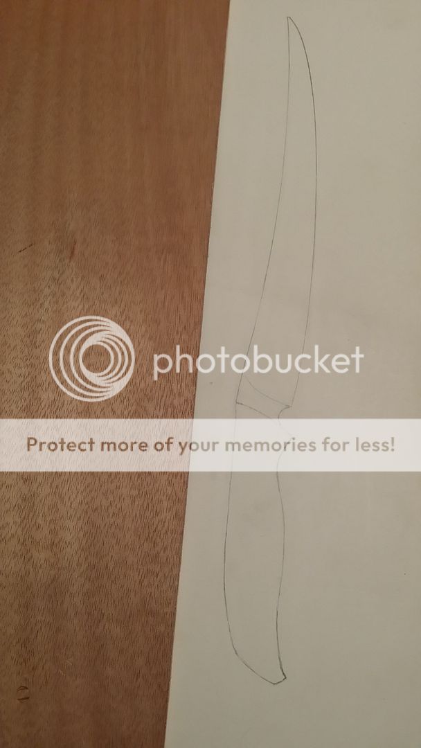

I had an idea of what would work for my uses, so I decided to sketch what I felt would work.

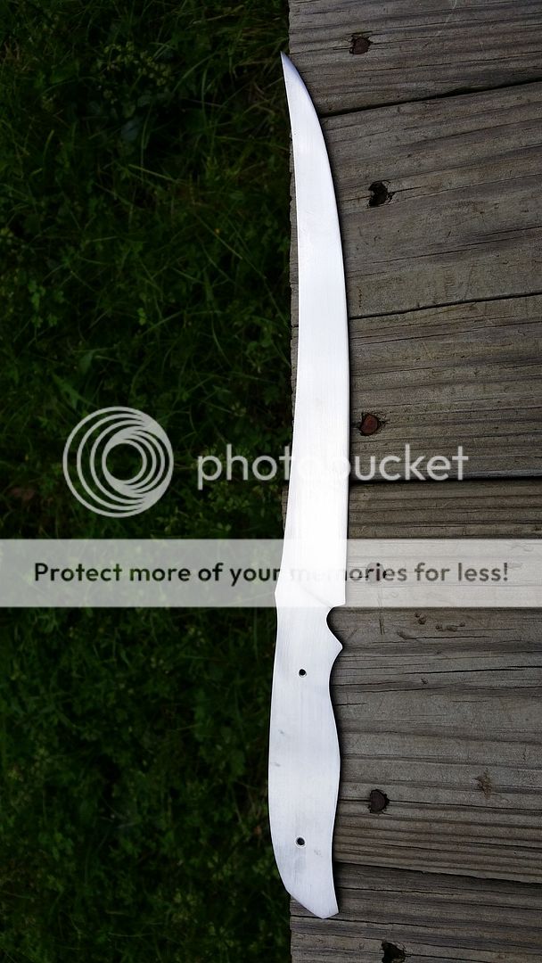

I chose 15N20 steel for this project for its properties and that I have the ability to heat treat it myself. I started with .080" thick stock and ground out the profile.

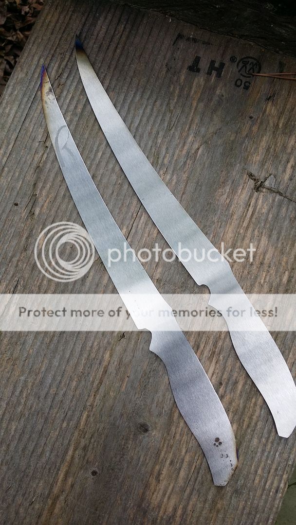

I then performed the heat treat techniques for this steel. Thermocycle, quench in heat treat oil and temper shooting for 60-61 Rockwell. I then ground the primary bevels and distal taper. I put an edge on it and began testing to see if I achieved my goals in heat treating.

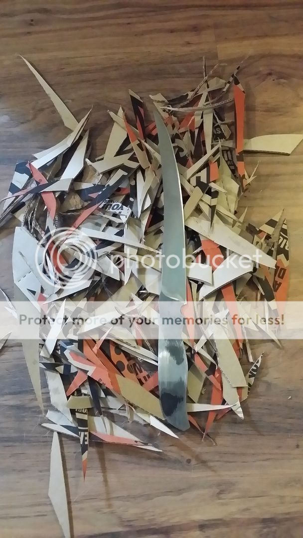

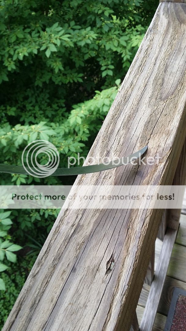

I sliced up a pizza box without any noticeable difference in how it cut.

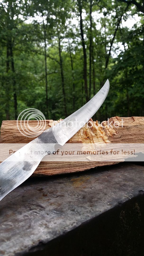

Some old pine knot to test how tough the blade is.

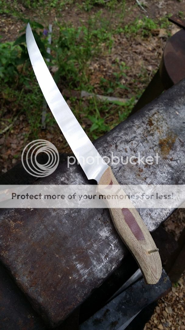

No damage to the edge and still cutting some hair, not quite as much as at first. But I am still liking where this is going. So it's time to see if it's got the flex I was hoping for.

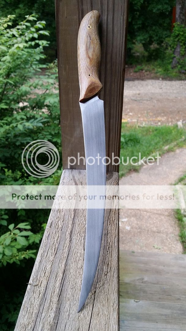

Good so far. Moving on to the finish. I really like a hand rubbed finish.

Looking great Chris. :thumbup: Did you grind the whole shape or did you use a plasma cutter or some other method? What do you have planned for scales? I can't wait to see the final product. :cool:

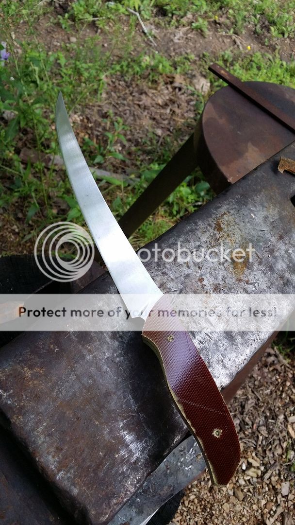

Bob, I ground everything on a 2"X 72" belt grinder. Micarta is what I have chosen for the handle. I will get some more pics up when I can, I should have finished pics tonight.

Bob, I have already finished the knife. My 50 hour a week work schedule keeps me busy. I am trying to post images from my phone as I have time and I am not so good with using photo bucket. When you decide it's time to try I will help in any way I can, even if there are guys here that are professional knife makers and much more qualified. Until then, know that you are in the prayers of my wife and I.
