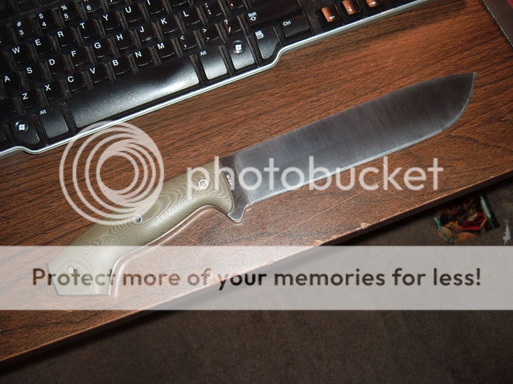

At G2 I asked Jessica Bybee what was new in the G10 world. She showed me some "messed up" G10 they had gotten in. Apparantly it wasn't what was ordered but it sure does have a great look! Comes in looking sorta camoish :) I finally got around to making a blade to use the stuff on. I made something big but not too big. Still a belt wearable size and weight. 14 7/8in overall with a 9in blade. I used my usual 1/4in thick 5160 for the blade stock but to lighten it a bit, there are 6 1/2in holes under the scales :) The scales started off about .260 thick so I used the extra material to get some cool contours in the slabs. This G10 has a similar shimmer to it as I usually see in the silver twill G10.
