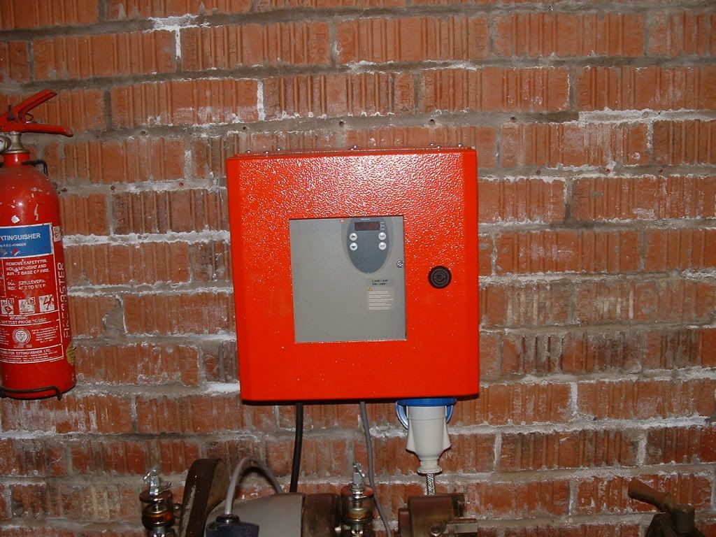

I put mine in an IP56 (NEMA 4X) enclosure with a 3-phase socket/receptacle for the machine and a remote control box on a few feet of cable that can be moved to the machine I'm using at the time. Over here it works out quite a lot cheaper than buying a sealed VFD and I figure I'm still in pocket if I fry the electrics and have to buy another VFD.
I know one or two folk who have killed unsealed drives quite spectacularly.

Mine seems to be doing fine with just the box. I lucked into a bunch of 12" x 12" x 8" steel electrical boxes with toughened glass doors during a clear-out at work a couple of years ago. I've fitted ABB, Siemens, Telemecanique and HuanYang VFDs in them without any problems at all. All have been 2.2 kW/3HP.
Please bear in mind that I'm in England (about 30 miles North of Manchester) with all that entails in terms of climate. Realistically, we don't get ambient temperatures much over normal room temperature at any time of the year, so cooling is not the consideration it would be in sunnier climes.
This one is a 2.2 kw Telemecanique Altivar
When the boxes from work ran out, I bought a 16" x 12" x 8" all-steel one for the next with an eye to getting a little extra surface area for cooling.
I wasn't so keen on that. I think the see-thru front is well worth having for the view of the display.
