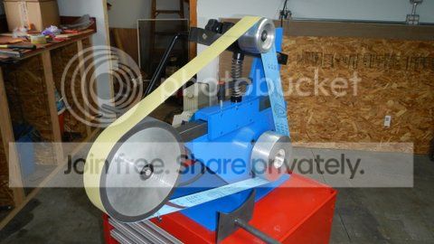

Hi Ryan, I sent you a email with some picture and some info on the grinders I build. For some reason when I try to upload pitures here I always get a fail massege.

Brett if you will email the pics to me I can post them here for you. I'd be interested in seeing your grinders. Email is in my sig.
I'll say up front I'm a friend of Brett's but my endorsement of his grinders stands on the merit of the grinder itself. I can attest to his detail and precision on the grinders. I'm planning on trading my GIB in for one now and add one soon so I have matching tooling.
The tooling interchange with other products like the Bader and TW90 is a huge plus.

Hey Ryan here are some shots of the grinders Brett is building.....
Ive commited to one myself!
