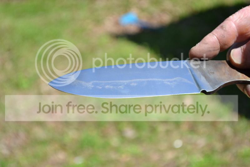

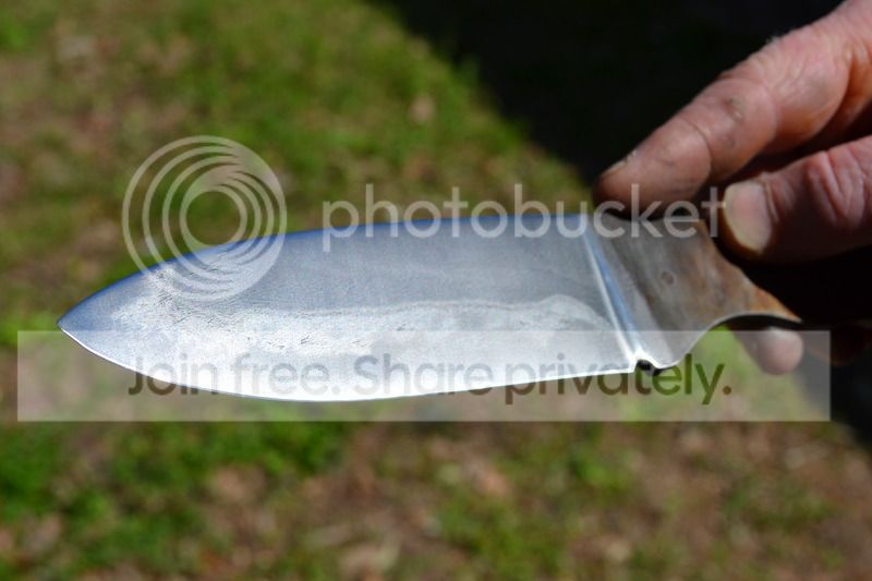

So to the question, this is knife number 2 or 3 (I have 3 I'm working on) and there is some crazy hamon activity going on, but I'm not sure if I can bring it out more. ( also not sure how well it photographed).
This is 1095 clay quenched, the hamon area is quite a bit bigger than where the clay was also. It was etched at 1000 grit in ferric chloride, than polished to 1800 grit.
Seems like the photos look a little different than real life, but hope you can see what I'm talking about, so is there anything I can do to bring it out more?
It looks like there are still grinding marks in the blade. Sand with 220 until they are gone, and go up grit by grit to 1000 or more, look up Nick Wheeler's hamon polishing tutorial. There is a lot of great info in there. Try different etchants. I like vinegar, then lemon juice. Others like ferric chloride.
That's not an 1800 grit finish. I can see grinder marks for sure all down the blade in the first pic. You need to drop back to like 400 grit maybe and start hand sanding. When you get to 1000 grit, with no deeper scratches under the finish (change direction by 45 degrees or so every grit step) Then etch. You didn't mention what you etched in, but I hope its ferric chloride. Dilute it 4:1 or so with water, and do multiple etches for a minute or two at a time. Until the blade goes all black. Then pull it out, scrub the oxides off with flitz or something, wash hard with detergent, etch again. Every time the hamon should pop a bit more. Don't sand in between etches, just scrub clean.

Yeah I knew I still had some scratches in it, I realised I had rushed it and was pretty far into it. I did use ferric chloride but I don't think the dark hamon is what I'm looking for.

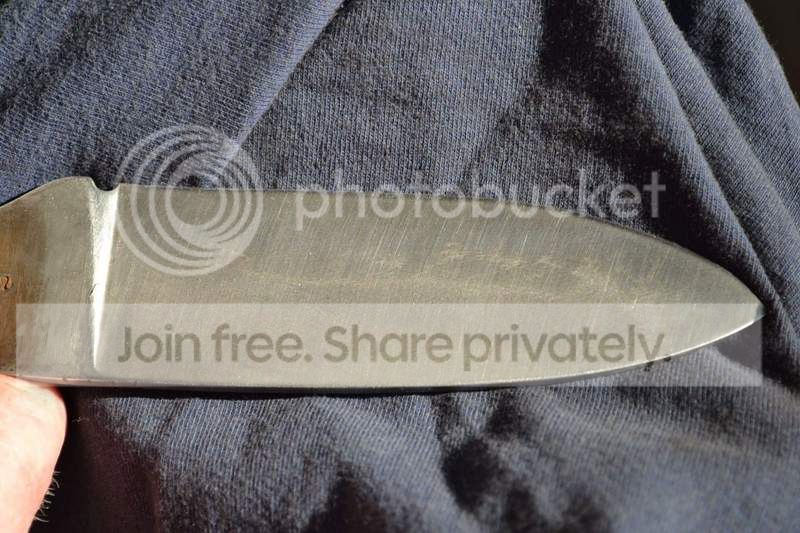

Thanks again for the reply. Yesterday I went back and sanded from 220 to 1000, then etched again. It has a nice dark hamon, needs more polishing for sure.
I am going to work on it today and then try to get a couple pics in the sun.

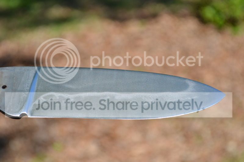

Not the best pictures in the world but here is where I am right now.
The least active side.
like this better

It looks like you still have some decarb to go through. Back to 220, sanding until the decarb is gone, then up through the grits again. It's a pain in the xxx, I know.

Some people use a light clay wash over the blade before the thicker clay for the pattern. I don't. I leave my blades at 0.030" at the edge before heat treat. There can be up to 0.010" of decarb to go through, but it's usually about 0.005". I leave extra as I've had a few that ended up too thin before getting through the decarb. I do the normalizing and thermal cycling before grinding the bevels. If you do the bevels first, then cycle, the decarb will be deep.

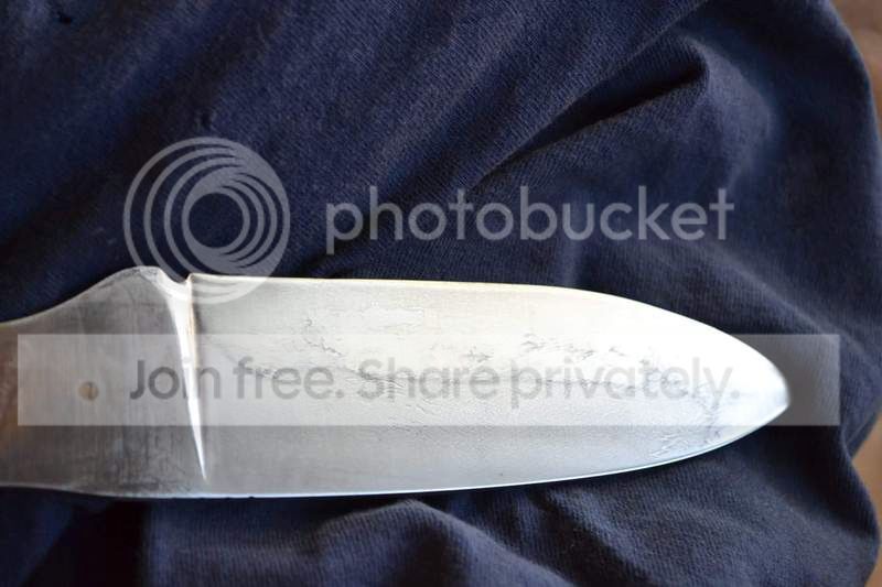

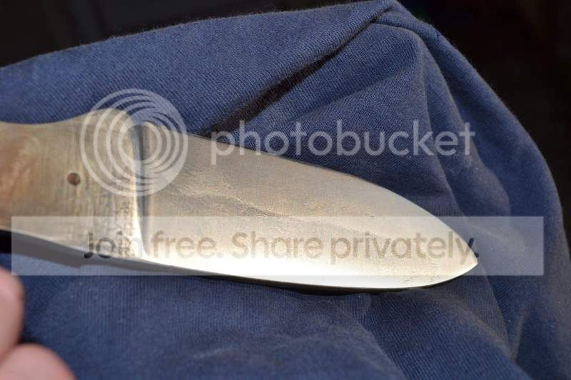

Little update, I took a break for awhile due to time and stocking up on sandpaper, belts and grit, i took it out today and I was going to etch and scrub with the loose abrasive and crap, there is some very fine pitting on the blade.
I had wiped it down and oiled it with some olive oil, (first oil I came to), but that was a couple weeks ago.
So I guess I am going to try sanding again and see if I can get the pitting out, this knife may drive me mad before it's over.
Anybody ever had one with very (I mean very) fine pitting and did it come out?
