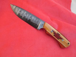

When I first started knifemaking all I would use to attach scales to a full tang were corby bolts or loveless bolts. Then at a knife show I spoke with several successful knifemakers and they said pins would hold the handle on just fine. Since that time I have used pins either 1/8" or 1/4" on over 1000 knives. There has been absolutely no problem with the handles coming off.
I sand the pins to give the epoxy something to hold on to. There have been a few times I have needed to replace a handle and it was very difficult with the pins holding it on.

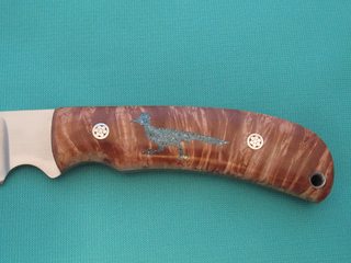

If you look at the 37th editin of KNIVES which is advertised as "The worlds greatest knife book" you will find some handles with corby or loveless bolts, but there will be plenty with pins. Including two of my own knives on pg. 106 and 153.
Lots of knifemakers including myself like to use mosaic pins and they hold just fine.
