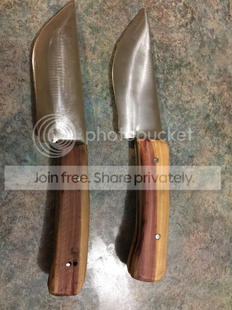

hello everyone, been reading on here for a while and thought it was time to introduce myself, i've always liked knives and about a month ago i was talking to my buddy about that show forged in fire and told him i would love to know how to make a knife(pretty much the knives they sell in the stores are junk) and i have basic skills working with steel, so as a joke i figured hell let me try it so i got a mowerblade and cut it to a knife shape grinded it and did a kind of a heat treat, for the handle i got a piece of cedar from 1 of my trees and used it to make a handle, when i was done i couldn't believe how it came out neither could my buddy it holds an edge better than my benchmade, and yep now i'm hooked, now i'm actually taking my time on one and if it comes out good might make so xmas gifts.here a pic they're ugly.
Not bad for firsts! A belt grinder will speed things up but a good set of files will work just fine. Make a filing jig if you're going to use files and find a drill press for the handle and scale holes. What are you grinding with? Welcome to shoptalk.

For a first shot, those aren't too bad. If you keep at it, you will look back at those one day and be proud... but a little before that, you'll hate 'em and want to fix them up... DON"T. Keep them as a reminder of where you started. You'll be glad you did.

Welcome, Rick. Not bad for a first set of knives. As Rick M. said, keep them and look at them in several years. You will be amazed. I still have my first knife from 55 years ago. It is a reminder that we all start off the same. From there it is a matter of how hard you work and learn to get fit and finish down.
The stickys at the top of the Shop Talk page have tons of info. There is a tutorial in them, "How to Instructions for Making a Knife". It has a lot of info on starting simple.
Get some blade steel, handle wood, and make some more knives. A good steel for your point in the craft is either 1084 or 5160. Cocobolo is a good wood for early knives because it doesn't require much more than shaping and sanding to look good. Ben Greenberg here on Bladeforums sells a lot of good wood at fair prices in The Exchange. He will help you in picking woods that meet your equipment needs, too.

matt r i used a 4 1/2 in grinder for everything, cutting disk to cut the blades( well several) and 36 grit to shape it and bevel them then to finish i used a 220 paper that sticks to an attachment on the grinder, i went through a million of those when i get to close to the edge it would rip them off

the one on the left was the first one, the one on the right second, i made it for my buddy
for the one i'm making now i'm using a belt grinder, i have a little hf 1by 30 and made a bevel jig (i guess thats what its called) to bevel it and it looks good so far, when i'm done ill post pics

forgot to add the knife i'm making now i cut it out of a piece of old angle iron, my neighbor has old machinery and gave it to me.
