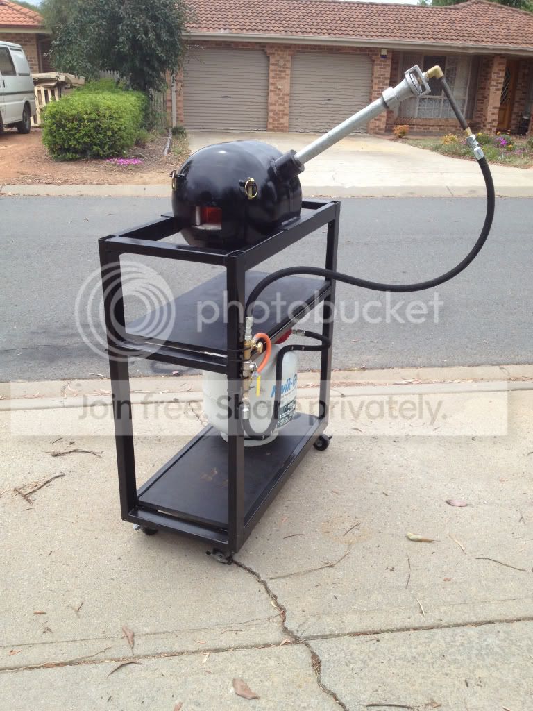

I decided in 2012 to make some knives and spent the next year getting some equipment. I got a 75kg cast steel anvil that came with an enormous 250mm 63kg bench vice! It also came with some hammers. I then went to a hammer in and built a gas forge. The forge is a 9kg gas bottle and was just the rough forge after the hammer in. Once home I cleaned it up, painted it and built a frame for it. It gets a lot hotter than pictured.

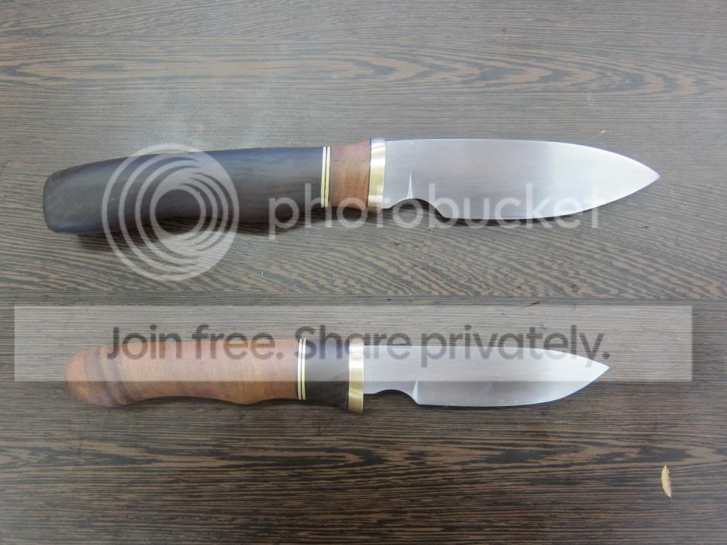

In Jan 2013 I did a knife making course at Tharwa Valley Forge and made two reasonable knives.
There is a whole bunch that needed to be touched up on these but I chose to leave them as they are, so I can see where I started. Both 1075 steel and forged to shape.

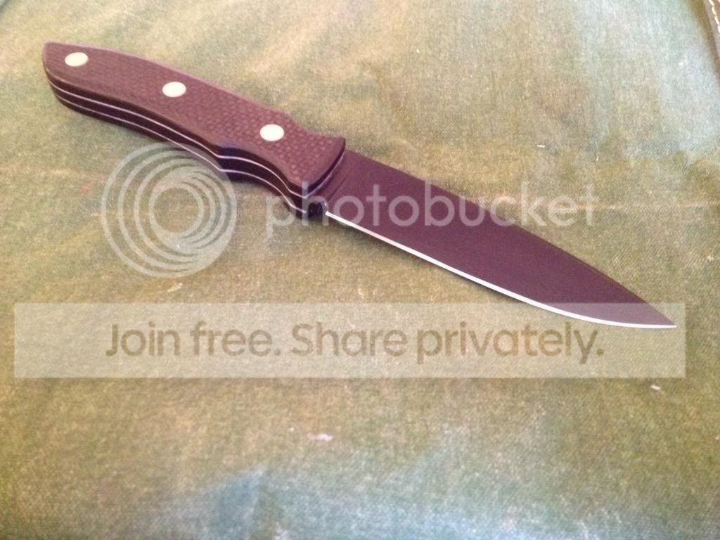

I've since made a stock removal knife. This is 5.5mm thick at the spine with a distal taper and swedge and a slightly tapered tang, carbon fibre scales and vulcanised fibre spacers with ss corbies. A friend did the Cerakote.

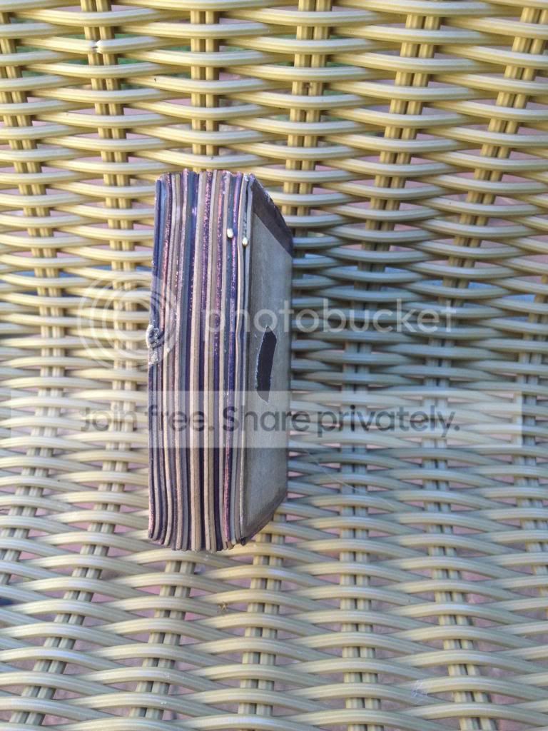

This is another of two blocks I made later of the three metals. Yet to be patterned. 30 layers and about 2 x 2 inches.

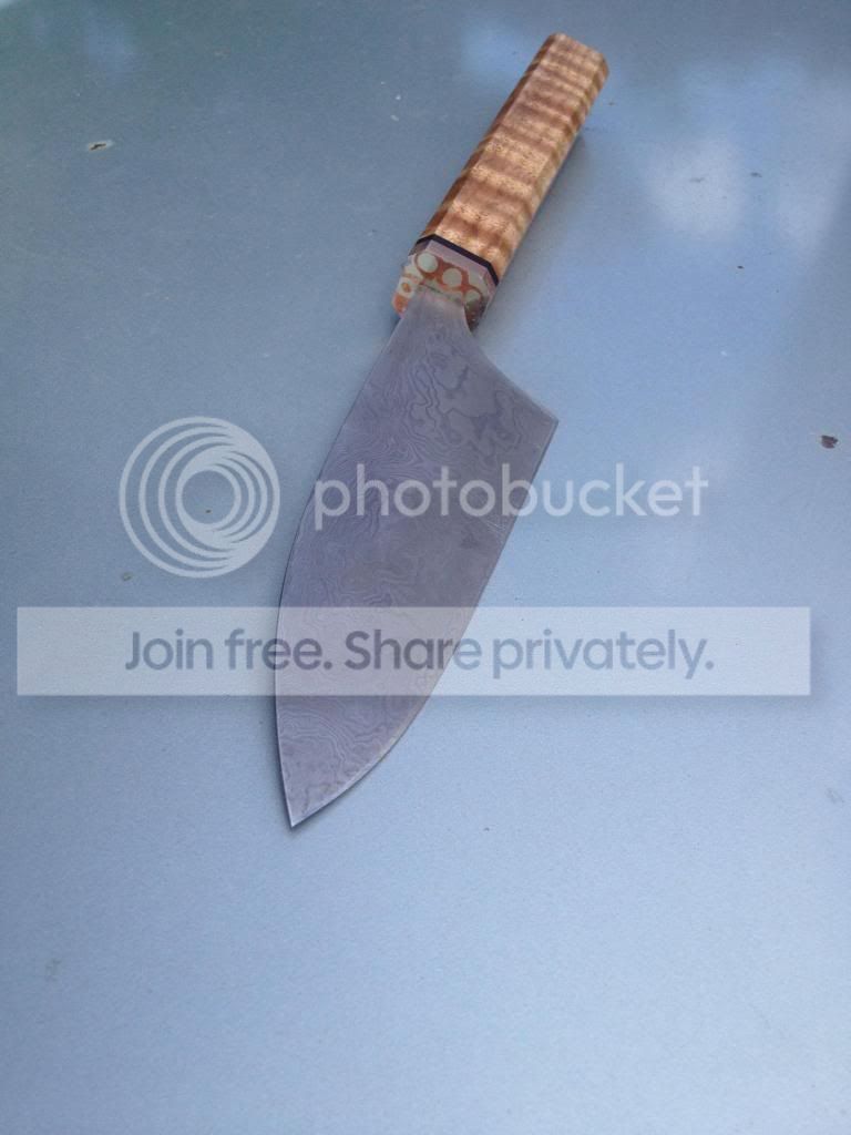

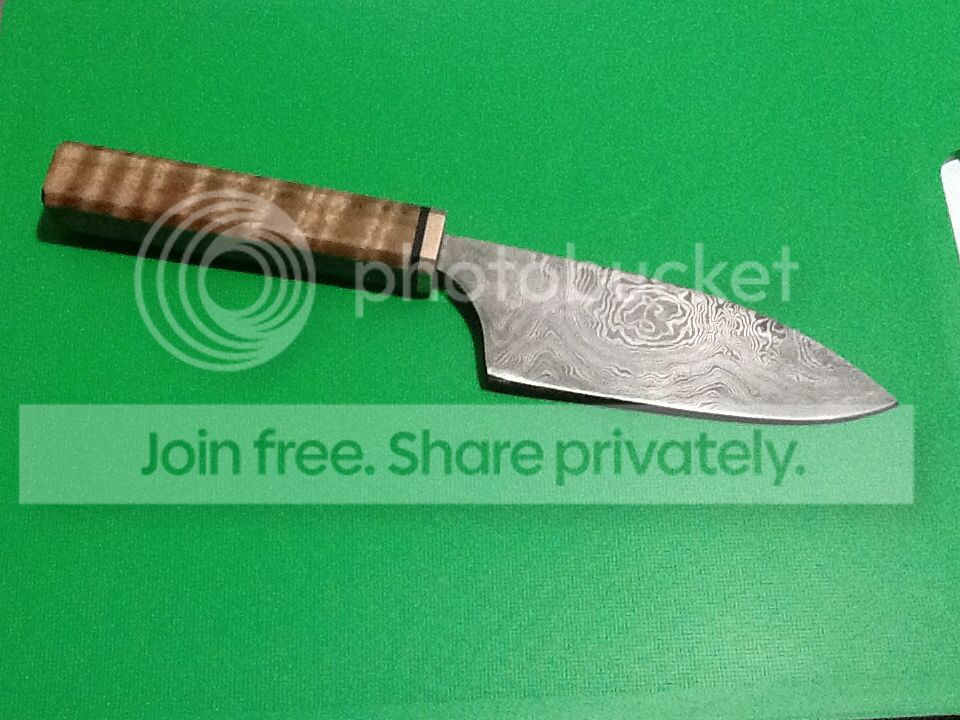

Once I'd finished with that I made my first kitchen knife and fourth knife ever.
I used the damascus I'd made, along with some of my mokume and stabilized figured tassie oak.
