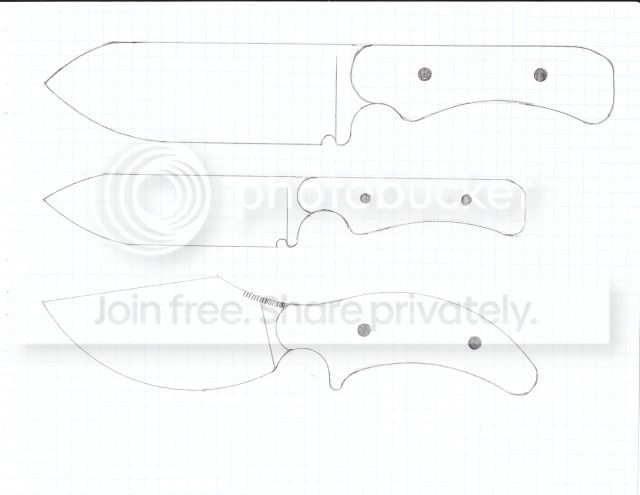

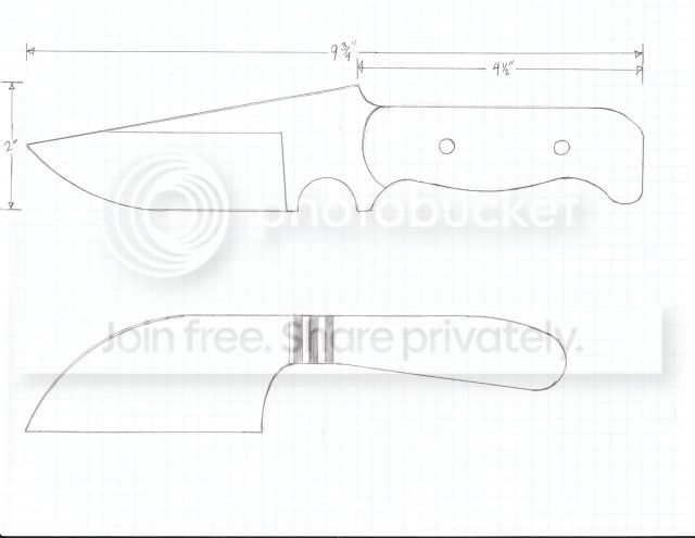

I do, I will have to scan them in, but I have drawings for probably a dozen knives. Not sure if any of them will get made the way they are drawn :D I want to start with a father and son set of utility/camp knives for myself and my 12 year old son who is a Boy Scout. I will see if I can get some pics up tomorrow since I am working tonight (unless I get bored and can whip them up on the PC here).
Ok, let's see if this works:
What I want to make first for my son and I (the top two) -
And one that I got inspired to draw after seeing the Les Suete Utility:
The first 3 aren't bad. You need to round out some of the sharper corners and get rid of the straight lines. Even very large radius curves are more pleasing to the eye. Cut them out of stiff cardboard to help work out the practical aspect. When I work on a design I usually have to go back and forth between drawing and cardboard cutout at least 3-4 times before I get to something usable. And even then it usually gets tweaked when building it.

I can see you’ve been thinking about this. Looking at the first set of three drawings my initial impression is “BIG”. There is nothing wrong with big knives, just keep in mind though that the process of making a knife is simply to remove all the metal that isn’t your knife. Typically the bigger the knife, the more metal that has to be removed, the more work there is involved and the more time it will take to do it, especially if it is being done with files.
The second set of two drawings also seem somewhat large to me, or maybe WIDE (from cutting edge to spine) is more accurate. Regarding the top drawing, what is the purpose of the half-circle cut-out right behind the cutting edge? Is it a place to place a finger to “choke up” on the blade for precision work? If so why not eliminate the cut-out and extend the cutting edge back to where the cut-out currently is. You would end up with more cutting edge, a sleeker looking design and your fingers don’t have to wander out onto the blade easier to get cut. The top finger bump thingy seems a little high also.
The bottom chopper catches my eye for some reason. It is not a style of knife I would think of making but I could see it being useful in the kitchen for chopping stuff up. For this one the extra width seems appropriate.
A father-son set of knives is a really cool idea. These would be pretty special knives for years to come. What ever you make will be special because it will be made with the heart as well as the hands. Would you consider taking an introductory lesson in knife making BEFORE you make this special set of knives?
Think about beginning with a smaller, simple, plain vanilla design that will give you plenty of challenge and experience so that you will be better prepared to tackle more complicated designs. I recommend using 1/8” stock and making a blade not more than 4” in length, and less than an inch high (cutting edge to spine).
But when all is said and done you need to make the knife that YOU need to make, not what Paul thinks you should make. I just want to see you hooked on the heroin of knife making like the rest of us. ;-)

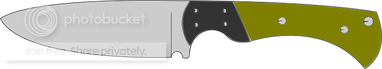

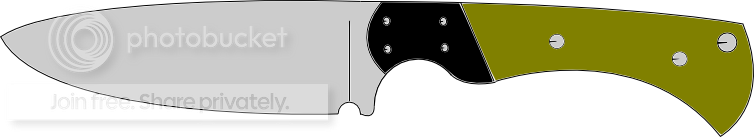

Ok, I have made a revision (only one so far) and was wondering what you guys thought about the changes I have made:
