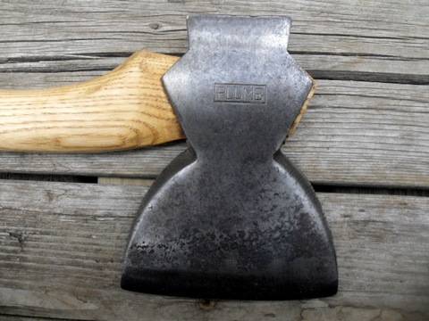

Unless that just says PLUMB maybe.. saw something similar while searching.. just not in same spot on head.

To me it does look like this, still cant make out the marking but same place and shape as this one:
I do have a brass wire wheel/drill attachment somewhere. Should I run it over a bit and see what it looks like?
Mm seems to scratch, or is that normal? Just hit it enough to knock the rust off, hardly any pressure:
Just tested a spot on bottom side
Definitely a Plumb. WD40 and very little pressure won't scratch it, those marks on the bottom may be left over from the manufacturering process. Test it on the bit or poll.
