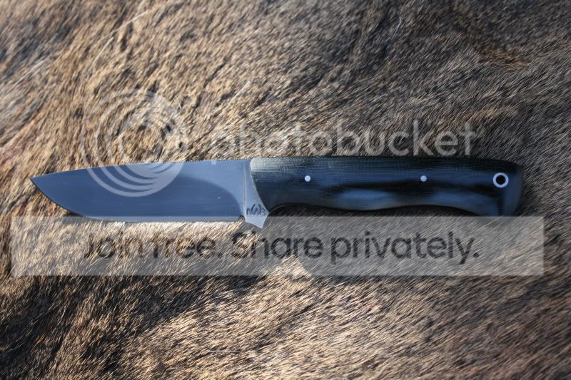

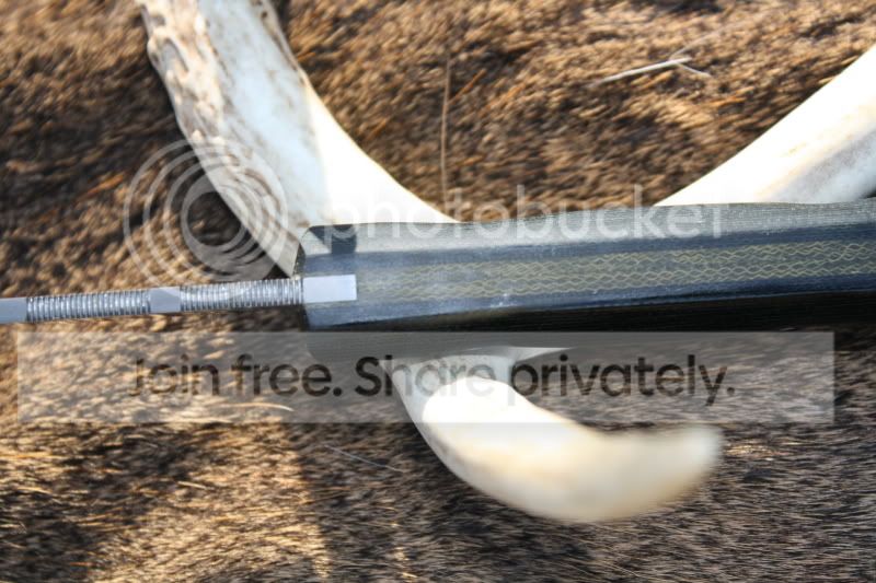

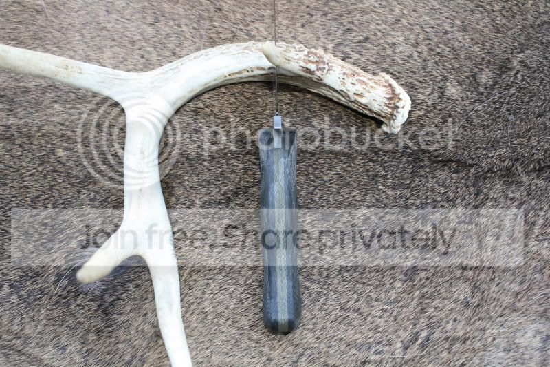

Here is another new one I just finished up today. It is a hidden tang knife for a fellow BF member. Hopefully, he sees this post.
Specs as follows
5/32" O-1 tool steel differently heat treated
8 3/4" OAl
4" edge length
1 1/8" wide
Fully Flat Ground to .018" at the edge
Handle is a combo of Olive canvas and black canvas micarta
This should make a fine wilderness/bush knife. All comments are welcome.

Nick, that is absolutely beautiful!
Seriously - I like that a lot - great work.
Someone is going to be very happy indeed. If they're not, you can definitely send it my way!
Man thats nice! Great work!
I can't wait till my camp knife is ready, I am getting all giddy!:o
Great knife ,I love hidden tangs I think they are as tough or at least very close to as tough as a full tang and they have better balance.

Good looking knife. I am a bigger fan of full tang knives myself, but your work is always excellent. Maybe I will have to order one from you soon...
Copy that Rockywolf:thumbup: I prefer tham as well. But this one does balance great, like Unsub said.
It sure is a lot more work to make one this way, but I really like the results. I couldn't have done it without the Mill I recently procured:thumbup:
The last pic has some smudges on the handle, from me playing around with it. I can't seem to put this one down.

Nice! I like exposed tangs, and your finger guard is hands down my favorite design. One of these days, I'll need to get on your wait list.
